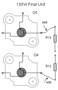

Why: This problem is caused by repeated thermal expansion and contraction of the cheap, phenolic printed circuit board [PCB] which eventually breaks the two, plated-through the circuit board connections between the output of the 10W driver stage and the input [base] connections to the 100W RF final transistors, Q4 and Q5. When the break occurs, the RF from the drivers does not reach the input [bases] of the final transistors, so there is no load on the driver output transformer, T2. Without a load on its secondary, the peak RF voltage across the primary of T2 runs wild and breaks down the collectors of the driver transistors. When the driver transistors fail and short,, they destroy the bias transistor, Q7, as well. Changing these components is an unpleasant and uncheap job. Worse than that, the same components will most likely fail again unless the real problem on the PCB is taken care of. Fix: On the component side of the 100W Final Unit circuit board, install a jumper wire between the (outer) end of R12 that is nearest to the base of Q4 and the base lead of Q4. Install a jumper wire between the (outer) end of R13 that is nearest to the base of Q5 and the base lead of Q5. These two jumper wires make sure that the driver RF arrives at the final amplifier transistors, whether or not the plated-trough connections are are doing their job.
Another method of fixing the problem is to solder Z-wires in the plated through holes. [a Z-wire is a wire that is passed through the board and whose ends are bent in opposite directions so that it will stay in place during soldering]
