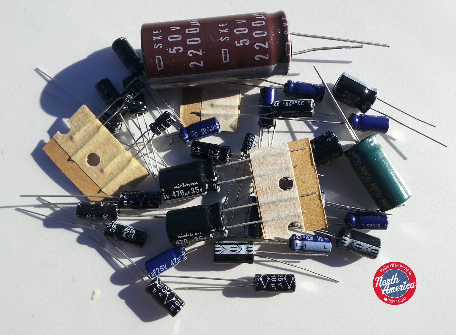

This will help you get started down the right path; "Electrolytic capacitor kit for Cobra 1000 (PC-407AC)"
https://www.ebay.ca/itm/142009625640

Yeah I kept on with replacing the caps. Only found one I didn't have. But have more on the way. I found my modulation problem, a solder joint on the board. Still keys at 9 watts and has an outrageous swing. 27 pep. I didn't think this 2092 would do that. D92 was the culprit for the power loss. Didn't look bad until I touched it and it fell apart. I've got power at 13.84 going to the board from the internal supply. I appreciate all the help you guys have been. I hate sending things off to be restored, it takes the fun out of it for me. The shack is my fortress of solitude from the wife and kids lol. I keep a camera above me to record every thing I do so I can retrace anything I do. Will keep on re-capping and get back with an update

Finished re-capping, still have a 10 watt key and 28 pep. Picked up some audio according to meters. On the internal supply I have those numbers. I also have a motor boat sound in my rx and the transmit light stays on. On the 13.8 plug in, those problems go away. Of course my numbers go down. 5 watt dk and 22 pep. That motor boat sound started when the fuse popped. Still looking the board over for bridged solder joints. I always take pictures before in case this happens. I know y'all are shaking your heads but if you don't ask questions, ya never know. Thanks again
