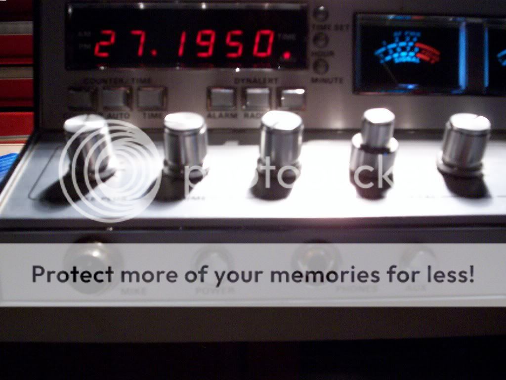

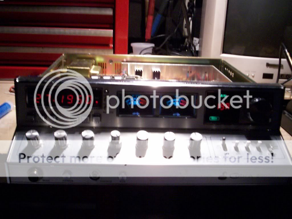

here are some pics of my 2000GTL as i currently have it set up:

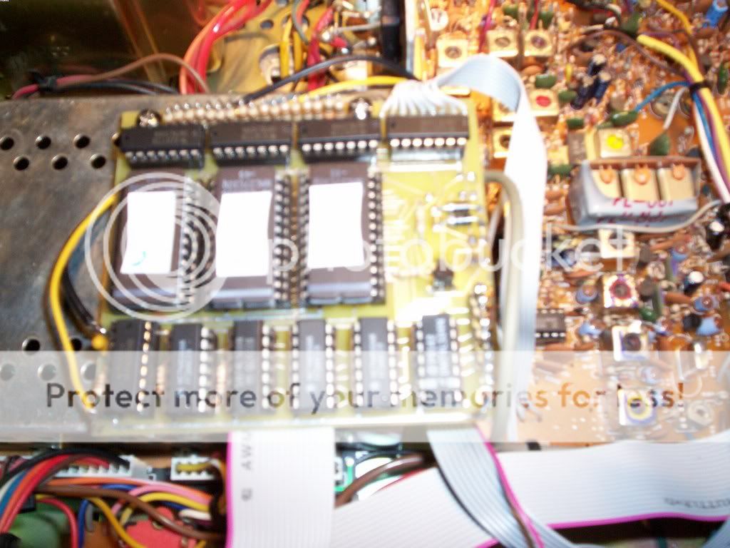

this is the mod board (revised beta board version 1):

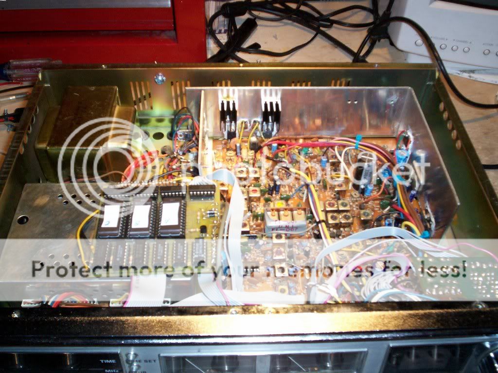

radio with top cover off:
closeup of "the button", and external audio input:
"the button" is a bandswitch which jumps in increments of 40 channels. i used a power switch from another 2000GTL and a tactile switch to make it.
the PHONES jack is now the external audio input which allows me to plug in a mixing board, mic, CD player, and my personal favorite, an electric guitar!!!
when receiving, the sound comes through the speakers.
when you press the mic button, the sound goes over the air.
i have lots of fun with this radio!
