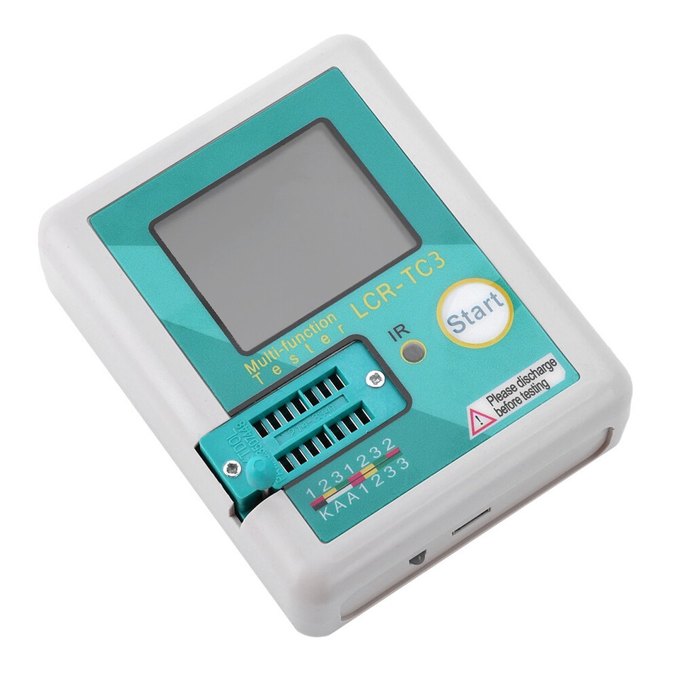

>> ... why not just power it up and see if you have 5.6v there?
Yup. Easy enough ... Any hobbyist working on radios should at least have one of the multitude of inexpensive transistor checkers that will also have a zener diode test function. This one would be a good addition to anyone's toolkit.
