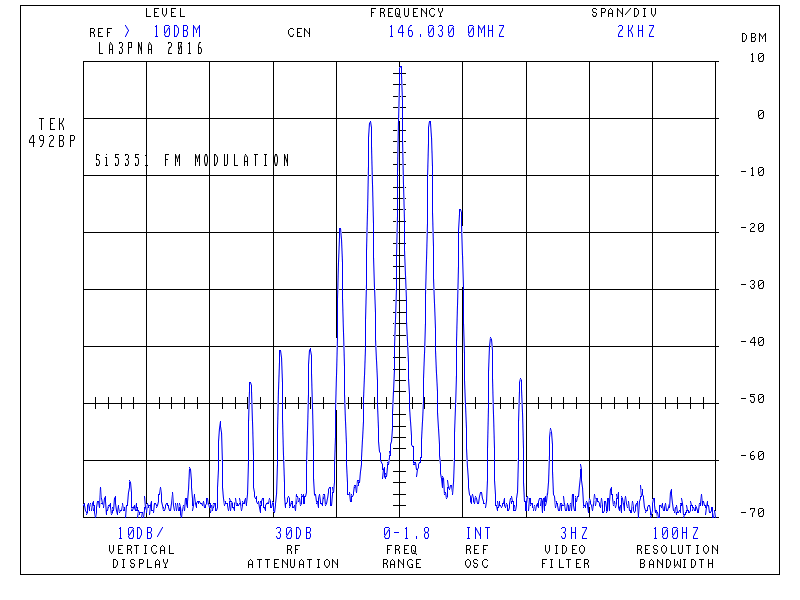

I didn't know it was possible, but apparently you can FM modulate the Si5351:
What I don't know is when you do what the article suggests if the FM modulation only shows up on one output, or all active outputs?
