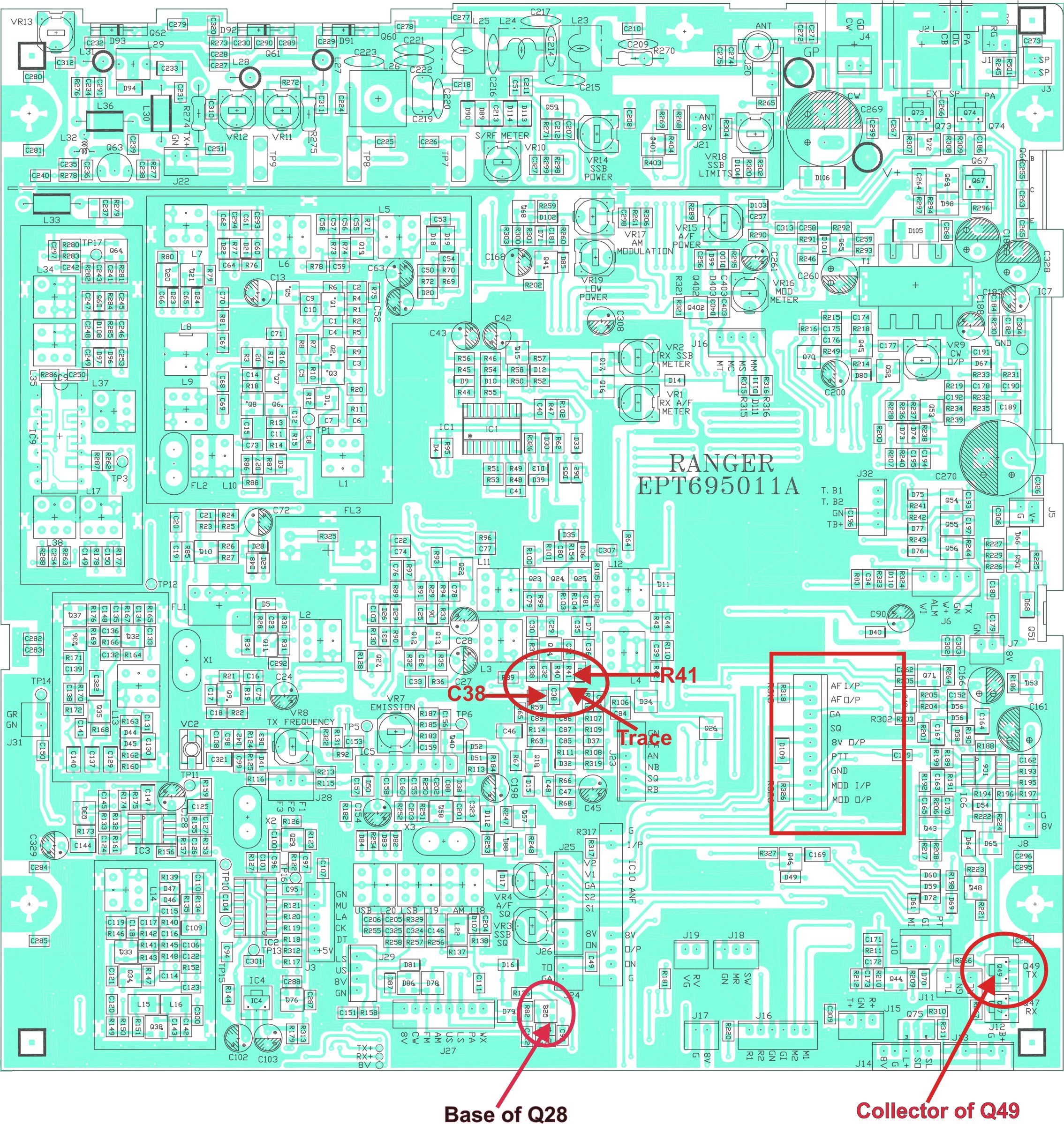

A few years ago I bought an RCI-5054dx. I was interested in connecting a Tone board to it so I could work 6m repeaters. Paul- CDX-8412 came to my rescue. He photographed the process. I would like to share it here that someone may receive help from what Paul shared with me. Thanks Paul !
1. Locate a row of 9 eyelets on the right front section of the main pcb. These eyelets are labeled as follows:
AF I/P; AF O/P, GA, SQ, 8V O/P, PTT, GND, MOD I/P, MOD O/P
2. Wire as below:
TE-32 CTCSS Encoder Connection points on the radio + Voltage (Red) Collector of Q49 (TX+)
(This will allow the TE-32 to start encoding in less than 10ms) Ground (Blk) Gnd Eyelet CTCSS Output (White) Base of Q28 with a 100K Ohm resistor in series Shield Ground (main PCB) http://www.rangerusa.com/ctcss.html#te32
The above is from the Ranger site. The attachment at the bottom is where the points of connection are located.

Ranger states this will also work on the RCI-2950DX/70DX/95DX PCB
2. Wire as below:
