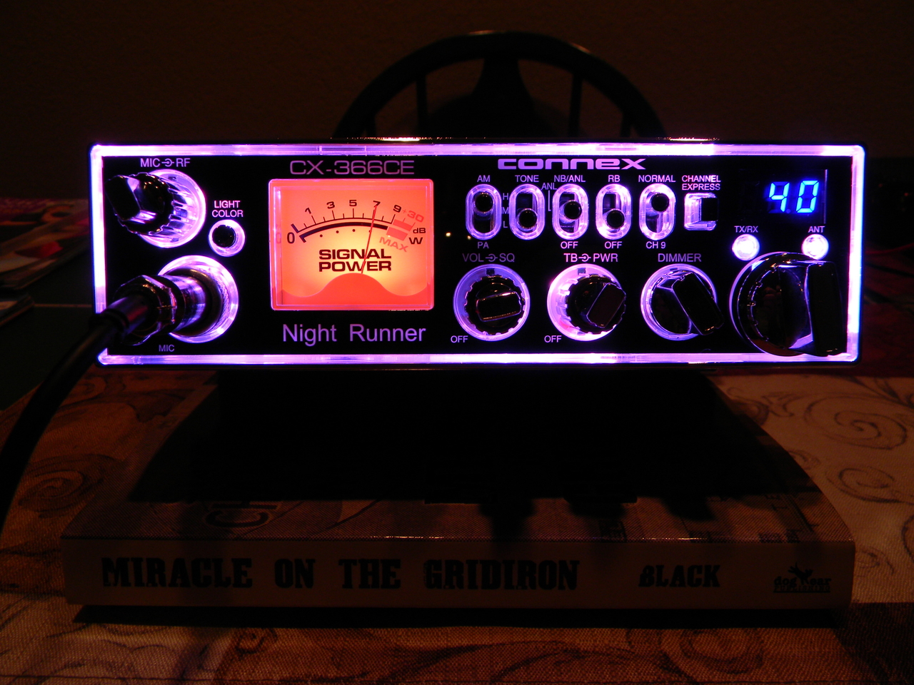

I had a high noise level in my home a while back. Finally found the culprits---a couple of energy saving light bulbs (the spiral type). When either was on, noise level was 7. When off, noise level was less than 1. Replaced them with the newer type of energy savers (not LED's---too expensive) and problem went away.
This pic was taken when I was experiencing the problem.
