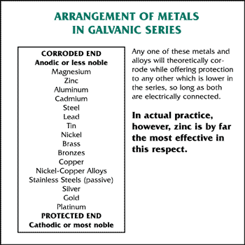

itx , according to Wikipedia there could be a problem .
379 , according to the AGA i should be OK .
................... thats if im understanding things correctly .
