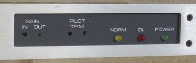

The 803 provided a visual means of knowing how far you were pushing the clip function. There were green and red LEDs on the front panel. As long as the green NORM LED was lit, you were doing no harm. When the RED OL LED came on, you were in the danger zone, although the industry joke was that OL really stood for 'Operating Level'. The 803 was undoubtedly the best-selling composite processor throughout the 1980s.

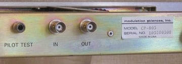

The CP-803 is a premium device. The quality of construction, both metal work and circuit board, is excellent. To ensure RF integrity, the top cover is secured with 21screws. The bipolar 13-volt power supply is isolated in its own enclosure.

For a CB or amateur station.....basically it wouldn't go anywhere. It is for a commercial FM station which develops it's modulation much differently that an AM station. We used to run baseband processors on our FM transmitters. Baseband is also know as composite and contains all the LEFT and RIGHT audio plus stereo separation information and 19 KHz pilot tones all combined into one wideband signal and carried on a single coaxial cable with BNC connectors. WE developed our stereo in our studio in a rack in the back and fed the baseband out to a 960 MHz STL transmitter. On the other end the 960 MHz signal was picked up and the receiver had a COMPOSITE OUT jack which simply connected via coaxial cable to the 50 watt exciter's composite IN port. No regular audio at all. What you REALLY want is an AM Optimod which is completely different from an FM Optimod. The AM version has regular audio IN and OUT available.
