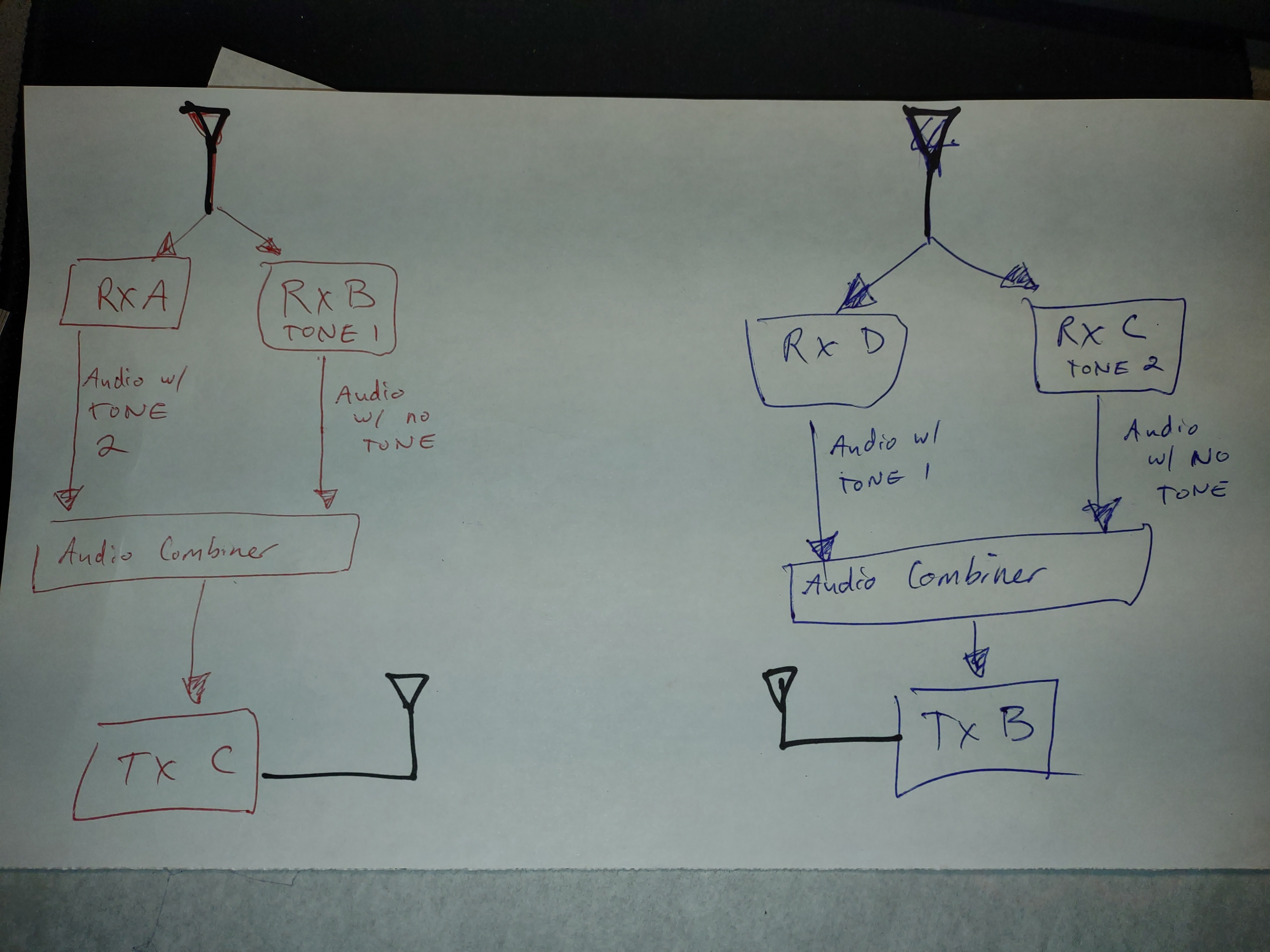

I believe I have a way to do it. For simplicity, I will explain the linking of two sites.
A few important notes first:
1. This will not work for repeaters using a duplexer, but it should be fine for repeaters using antenna separation or a diplexer.
2. The repeater must be able to activate a CTCSS tone during TX based on what receiver picked up the signal. For example, instead of using the transmitter to add the tone, having it added to the audio before getting to the transmitter, but from one receivers audio only, not both.
Take a look at the drawing below. Lets say I key up within range of the red repeater by transmitting on A. The repeater adds a tone to that and sends it to the transmitter and transmits it on C with that tone. The blue repeater picks up signal C with the required tone, but then passes that audio with no tone to its transmitter to be sent out on B. Since there is no tone leaving the blue repeater (because that only happens when locals transmitting on D are received), the red repeater will not key up on the tail end of the blue repeater as it finishes up because it lacks the correct tone.
