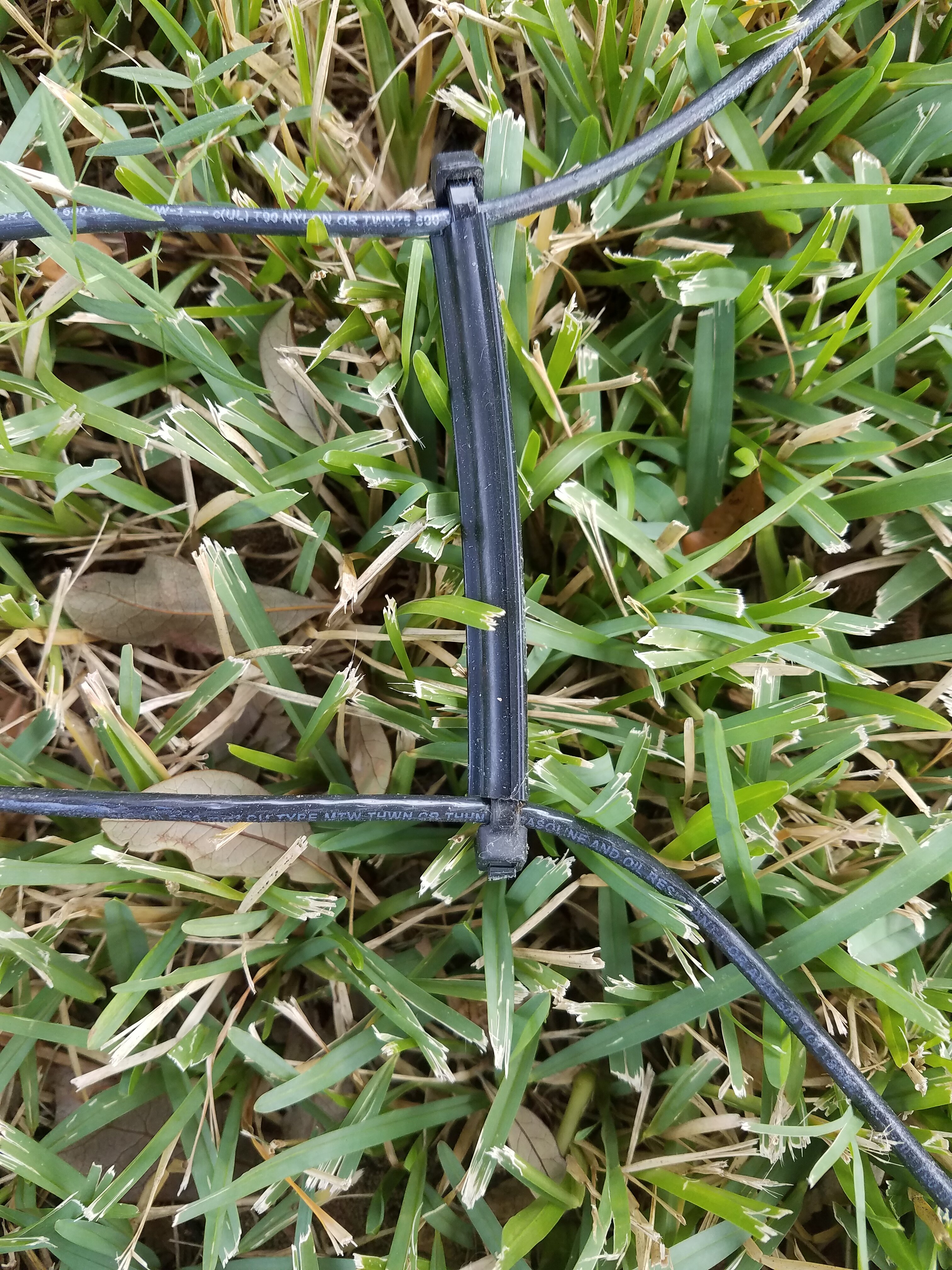

The 4 inch electric fence insulators work pretty well and you might be able to find them locally. All i did was run a pair of zip ties thru the tubes in opposite directions and secure them to the wire. Some people add glue of some kind but they don't move unless you pull them.
