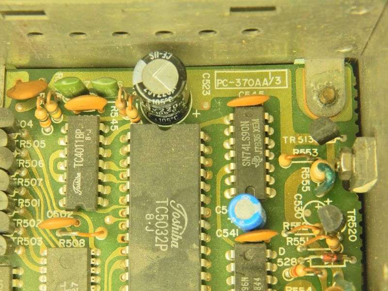

Here is the pc board number of the original 1978 Version, the one that needs the mod. Type "PC370AA".

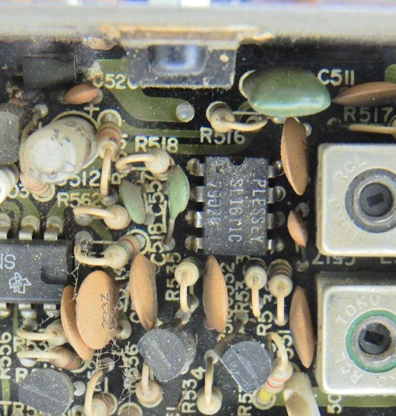

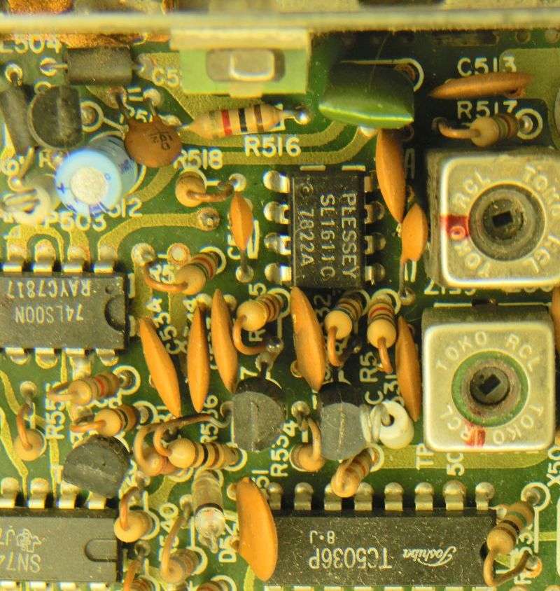

Here is the vicinity of IC512, the SL1611 chip.

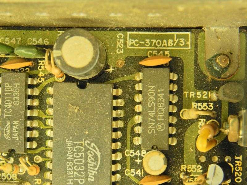

Here is the ID of the 'new' version, with the three new parts added at the factory. ID is PC370AB, (not "AA").
The sharp-eyed reader will see the new disc cap and two resistors that the first closeup of IC511 doesn't have.
If your counter module has the "AB" suffix on the board number you don't need to squint at the left-hand side of IC512 to look for the three added parts.
