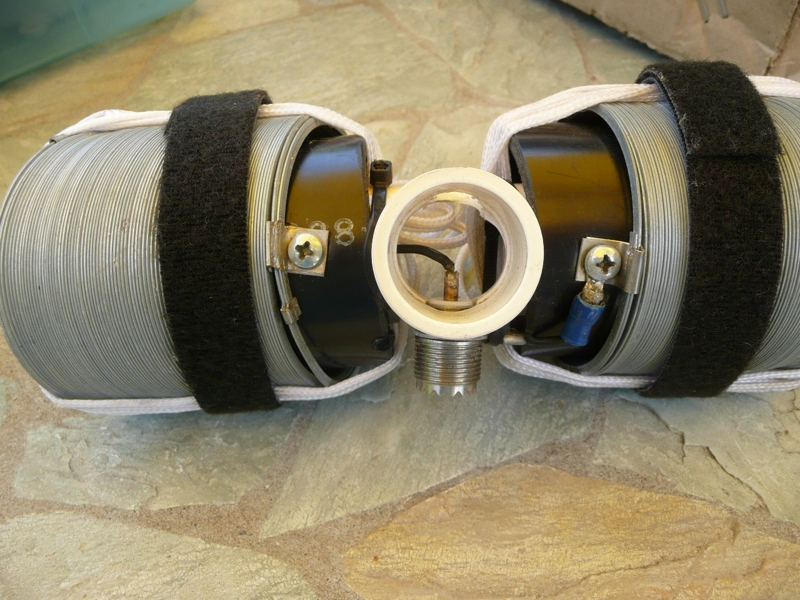

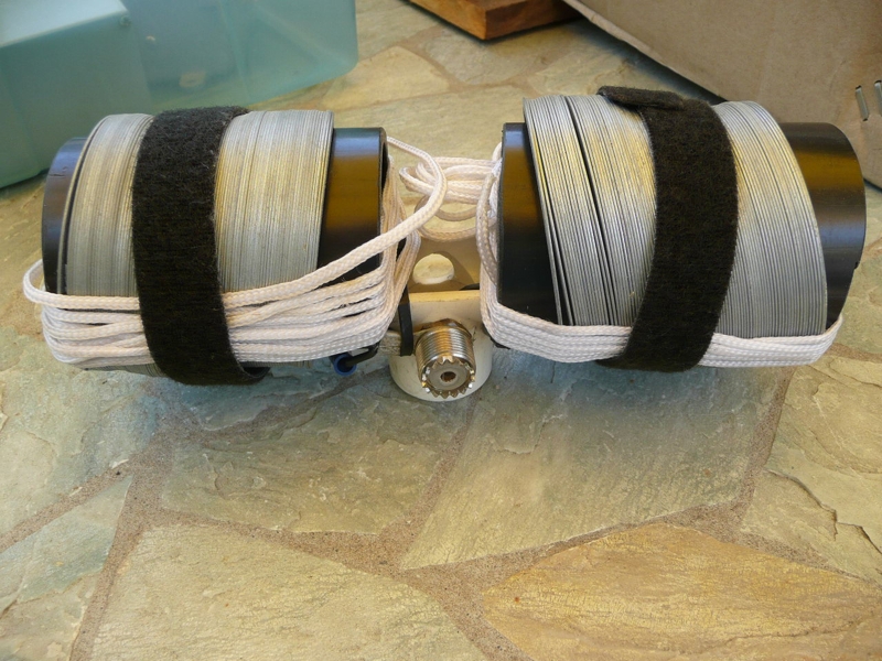

I found the old Slinky dipole after digging around in the garage a bit.
The SO-239 is mounted in a 3/4" PVC 'T' that I sliced the back side off of. The center conductor is strapped to one of the Slinkies, the shield strapped to the other.
I attached a couple of sections of 2" ABS outboard of the PVC 'T' to keep the Slinkies from becoming tangled when it's not deployed. The screws and nuts that attach the straps to the coils also secure the ABS sections to the 'T'.

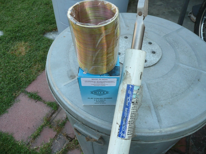

For the mast, I'm using a Golpher Pole®. It's a 20+ foot, 6-section, telescopic, fiberglass, wire installation tool. I've had it for over 20 years, so I don't remember the cost. The top section is .656" diameter, so it's pretty rigid, unlike some of the skinnier telescopic wire pulling tools on the market.
The radiating element/'Slinky'® is a United FCS003, Flat Coiled Spring that's 3" in diameter x 4" tall. They were purchased from Home Science Tools for a little more than $6.00 each. I purchased four of them, just in case this thing works well, and I can build some spares. If not, I can always use them for their original intended purpose - to amuse my family, friends or even myself :laugh:

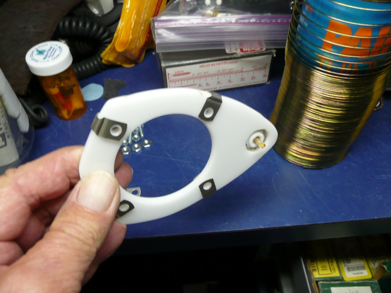

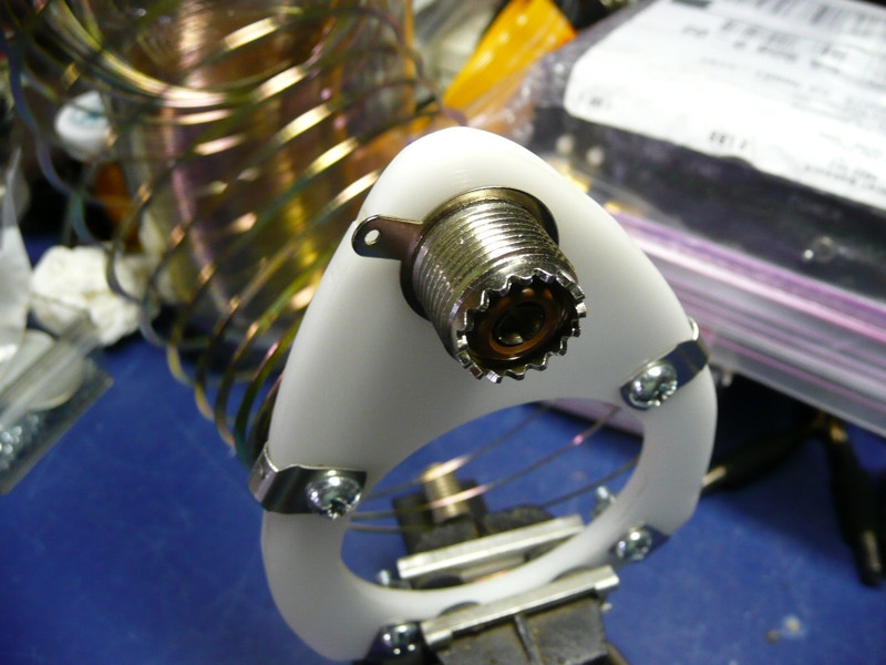

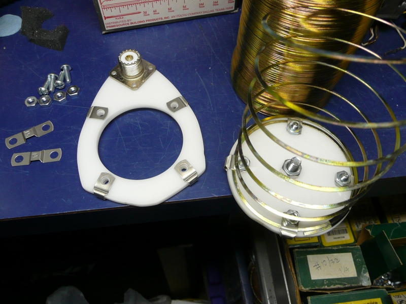

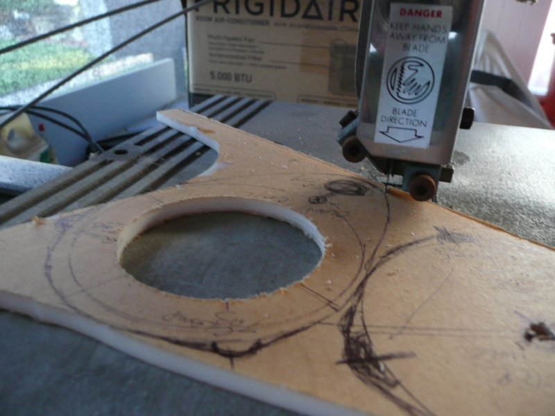

I rough sketched the dimensions for the top and bottom coil plates on some paper-covered 1/8" plastic sheet. The outside diameter of the plates needed to be a tad larger than the O.D of the 'Slinky'®. Next, I drilled the center hole in the bottom plate with a hole saw and cut the rough shapes out with a band saw. The center hole in the bottom plate needed to be a little larger than the outside dimension of the bottom section of the mast. A 7/8" paddle bit was used to make the smaller hole for the SO-239 UHF connector.

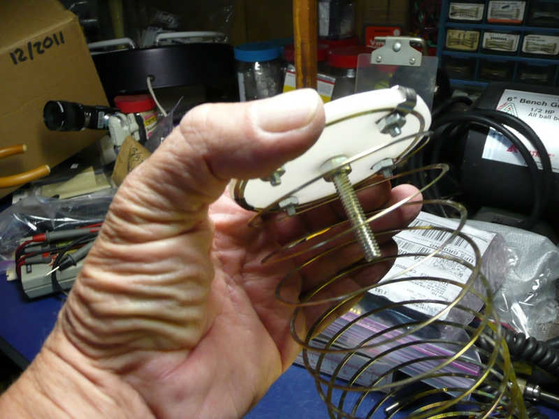

I peeled off the protective paper and finish sanded the plates to their final dimensions, bent some Panduit® stainless steel straps around the edges of the plates and drilled the holes for these clamps. Four clamps were used to secure each end of the 'Slinky'® to the top and bottom plates with #6-32x1/2" hardware.
I drilled a 1/4" hole in the center of the top plate and installed a 1/4-20x2" bolt to keep the top plate securely positioned in the top section of the mast. In the event a capacity hat is needed, a cap hat can be secured to the top plate with the center bolt. Just install a short #12AWG jumper from the center bolt to one of the top clamps.

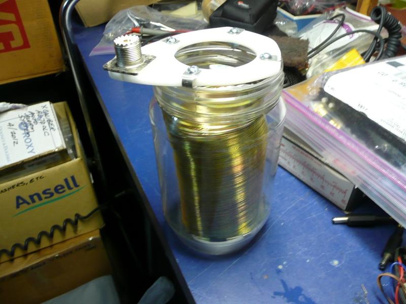

To keep the 'Slinky'® from becoming tangled up in itself, I found that it fits quite nicely in an empty JIF® 'Creamy' peanut butter jar. I guess you could use Crunchy (or even another brand) if that's your preference :tongue:

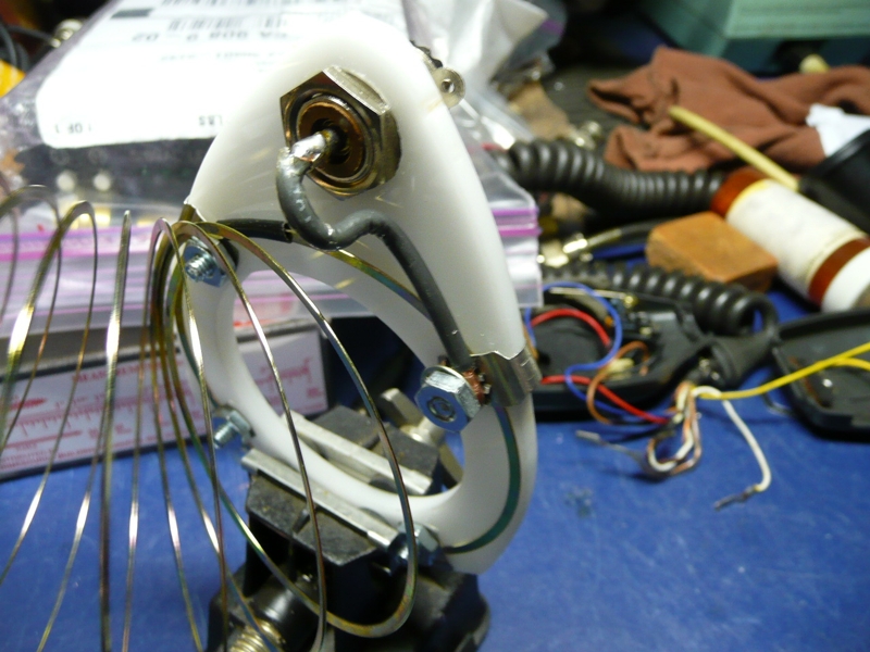

I picked up a different style of SO-239 connector, one without the panel-mount flange (my mistake in designing the size of the bottom plate too small), as the flange was too close to the 'Slinky'® element. Then, I soldered a 12AWG wire from the center pin to a lug that attaches to one of the clamp screws that secures the 'Slinky'® to the bottom plate. I used some serrated star washers to help grip (bond) the connection and included a ground tab, should the need for a ground or some ground radials be required.
