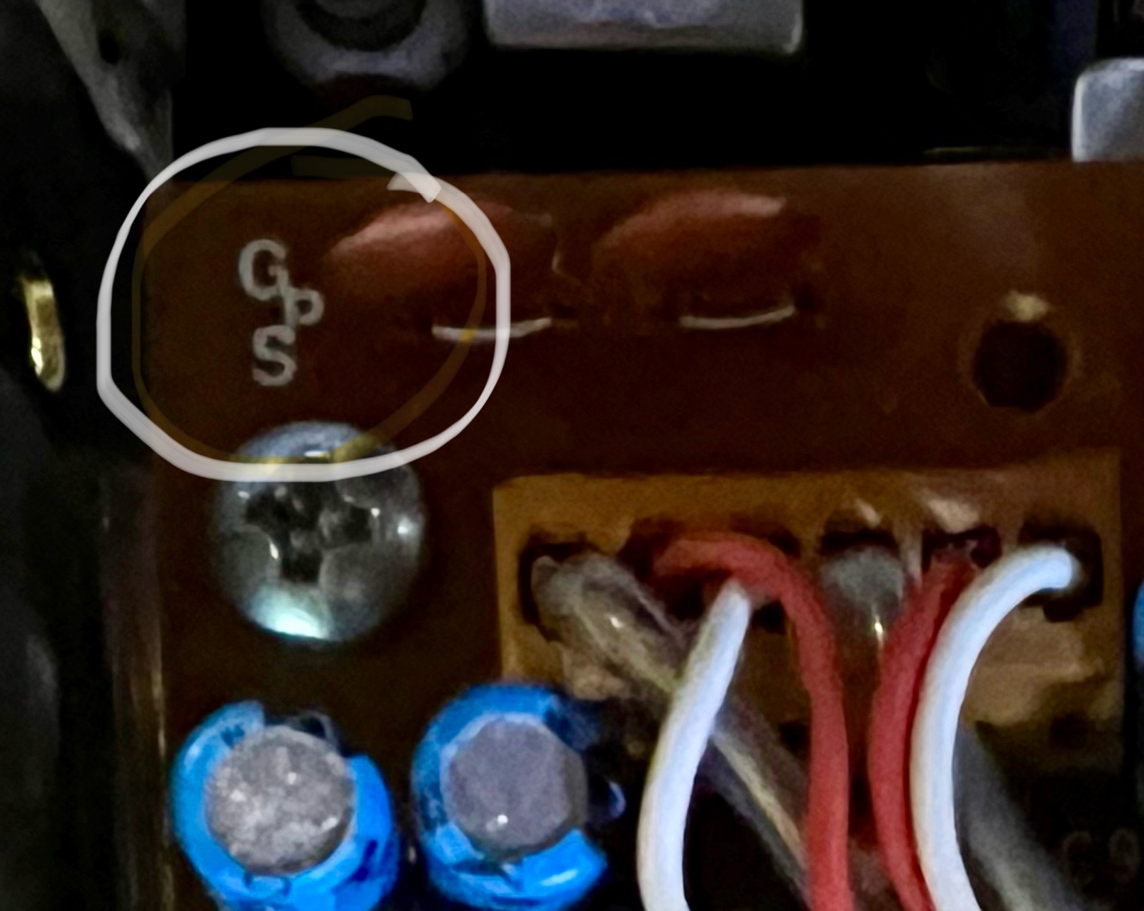

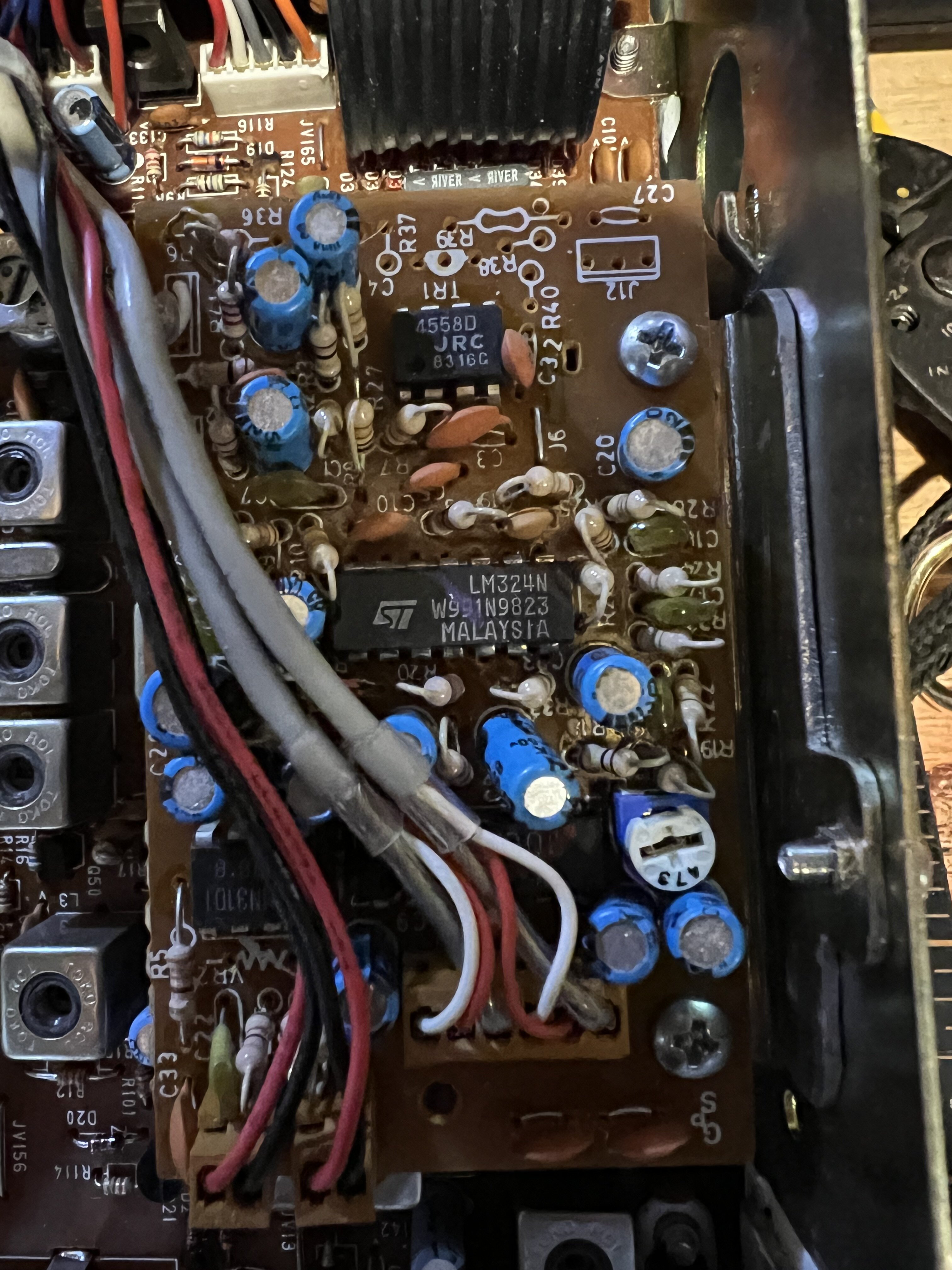

Popped the bottom lid off of my Uniden PC76XL and found this echo board installed. Can anyone ID which it is? The On/Off & adjustments are located in the formerly Delta Tune location. I’d like to locate the install procedure for this board, in case I’d like to revert it back to original.

The only thing I could see that looks like it might be a logo is this … but I assume that could also be the PCB manufacturer. I was thinking possibly an early Pro Trucker board. I’m fairly certain this was installed in the 80’s.

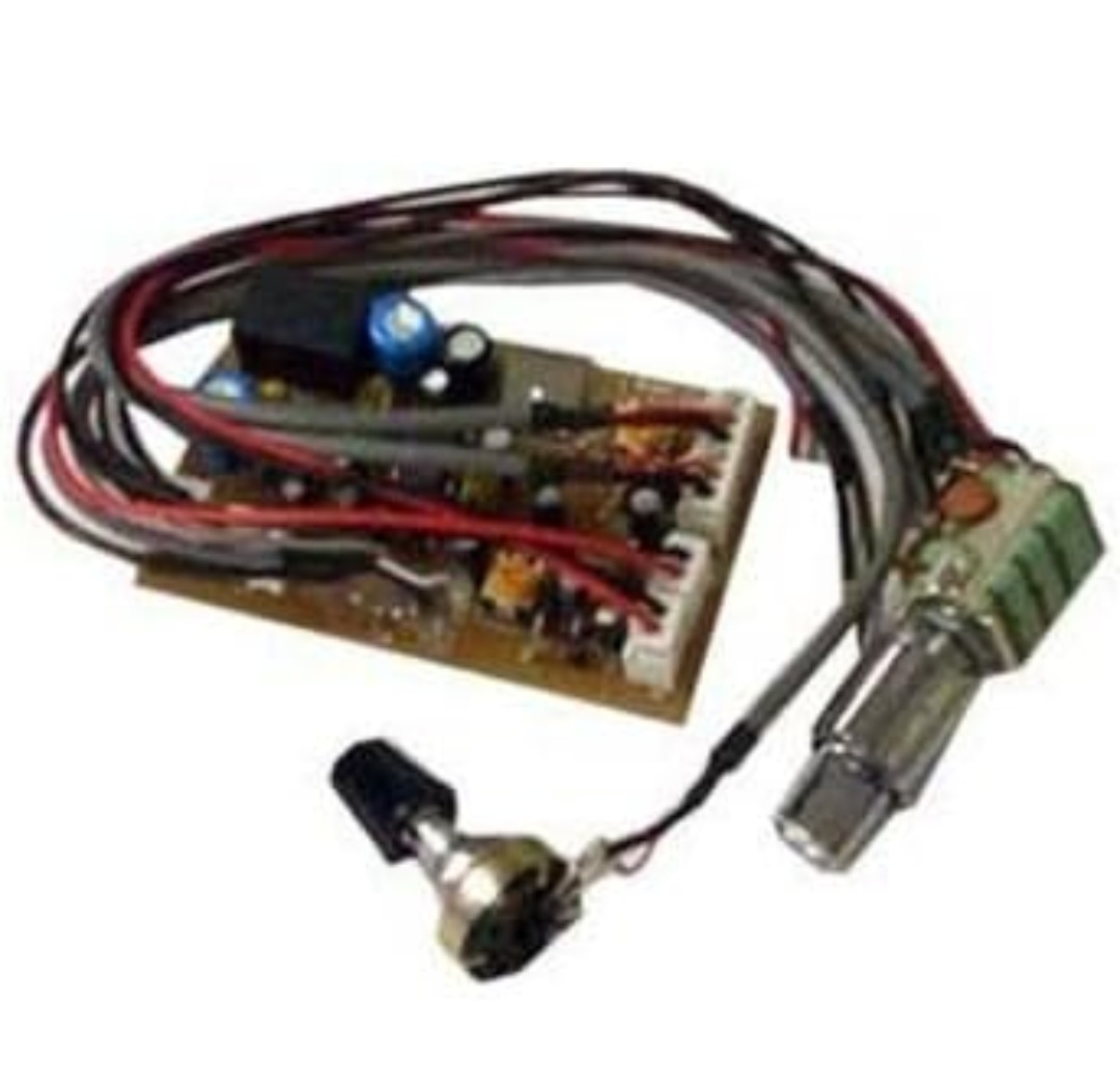

The pro trucker LT-2?
This is a really early version of it. Looks really similar.
What folks like to call a "Connex" echo is what the RCI factory installed in every Galaxy from that era. Board number is EPTSSB50-something.
It got cloned by more than one manufacturer, so it could be an original RCI-made EPT board, or a clone.
