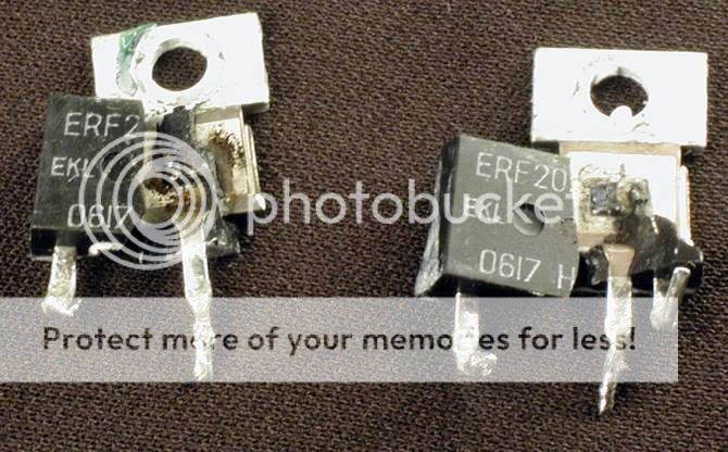

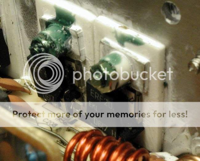

Well the higher the bias voltage is the higher your deadkey but you should not go any farther than 3.0 volts if you do it runs too hot. and we know what happens next
It is called
EXPLODE ! !
Thanks to Nomad for the photos.
Jeff
Thats a kewl pic. I have seen some 2sc1969's with a huge hole in them, and TA7222AP audio amps with giant parts of them missing.. and some 2sc2879's that had the tops blown right off them ! it's amazing what a semiconductor will do when the fuses are jumped out and the conditions are right !! lol....
I can not take credit for the picture, chris ( nomad radio ) shot the picture from a Magnum radio that he repaired.....
From Nomad Posted At CBTricks.com:

Best I can tell, the TGM is good for blowing up finals in radios using MOSFETs. This guy kept putting in larger fuses when they would blow out in his Magnum.
