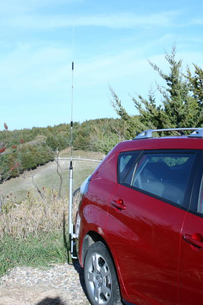

SG7900
Hello, I put the Diamond antenna in question on my XYL's car..well sort of...
built an extended feed mount for it that mounts to the tow-hitch location.
The antenna does say it needs no tuning and probably does'nt. But me being
who I am had to fine tune it...hi...There is inter-action on the two bands, just
like the Captain says, so be careful tuning it, or don't tune it is the best
advice really.
It has spots slightly lathe-turned down for the set screws on the elements, so
unless you are able to change that slightly you can't tune it...
The antenna is co-linear with a 1/4 over 5/8ths on 2m and supposedly 5/8
wave times three on 70cm if I remember right.
All that being said, I think this antenna has far out performed anything we've
used in quite some time, regardless of how it is mounted (or where)

Diamond SG7900
Never posted a pic here before, hope it works...
