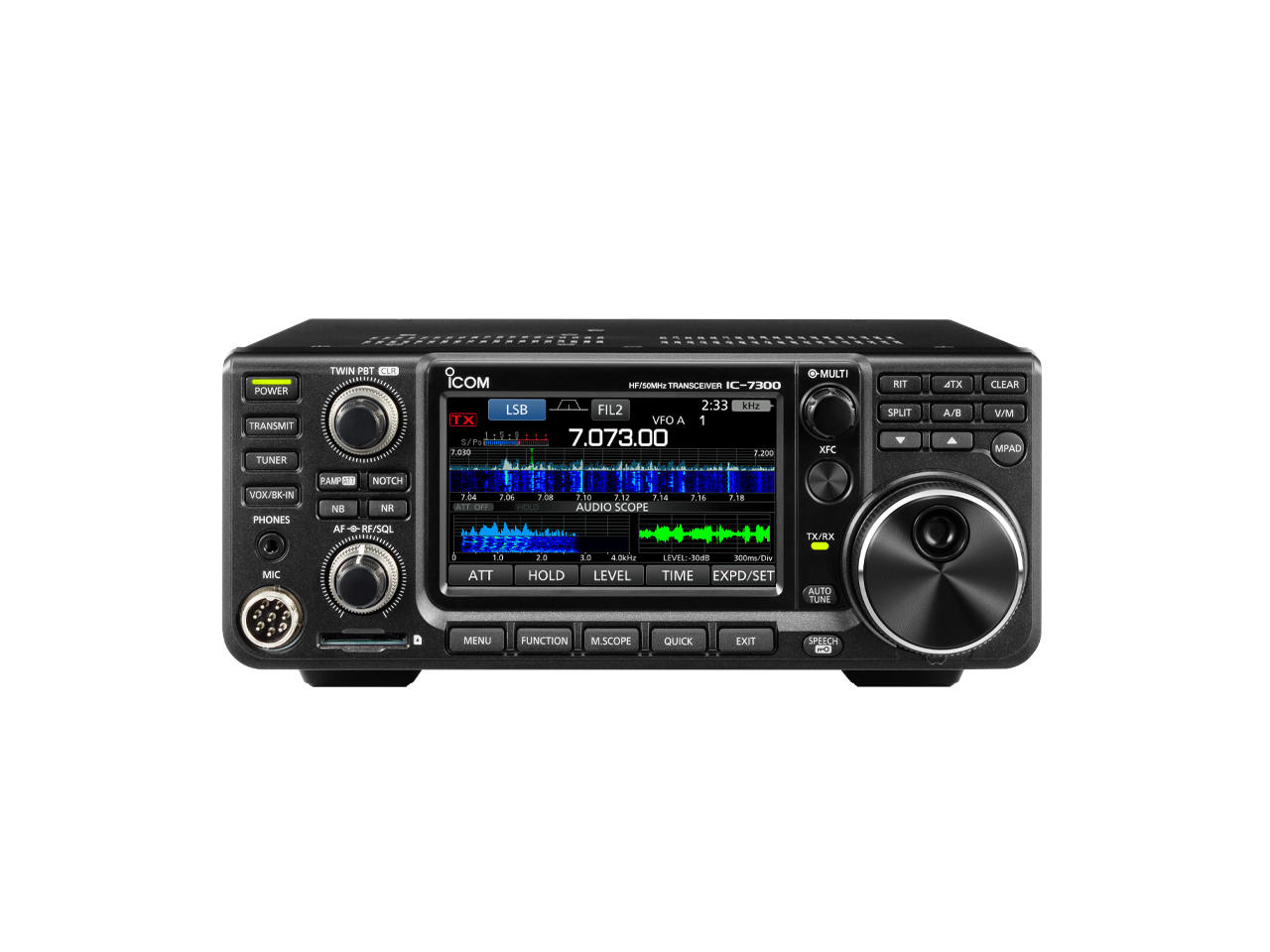

I would try very hard to get something as new as possible even if it is used. Just less possible trouble over the long run. IC-7300 or a Kenwood TS-590 should be trouble free for a long time if cared for. I still use a IC-7600 that I bought when they first came out. I've been a ham for 53 years, mostly a DXer, and don't see any need for anything newer.
Older tube or hybrid rigs are well, old! A full on tube rig may need some repairs once in a while. They should be something you are familiar with somewhat or know that they are in good working condition when you buy it at least. I have been around them a lot in the past but have no desire to own any of them again.
Most all of the more current solid state rigs are pretty feature rich and always have been. There are features in my 7600 I hardly ever use. Just don't worry about those features until you you think that you might like to try them out. You don't have to know everything about the rig from the first day.

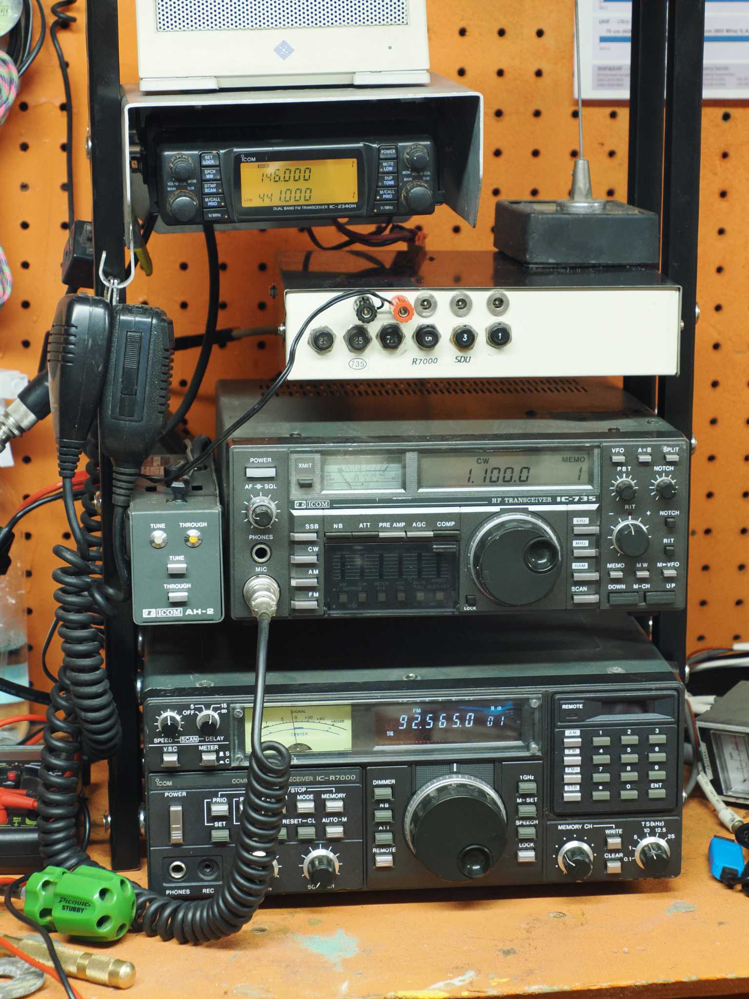

I'm still using the Icom 735 I bought back when dinosaurs roamed the Earth.
eBay says they're worth $250 and up, plus shipping, without power supply. You'll need 20 amps of 12-13.8 volts if you want full power out (200 watts PEP).
The receiver covers 100 kHz to 30 MHz. You can mod it to transmit over that range — not that anyone really needs such a mod.
Anything this age is likely to need its backup battery (CR 2032) replaced. I've done mine twice. It's not difficult, but the one that's in there has soldered-in wires, spot-welded to the battery.
I pulled off the spot-welds, stripped the wire back a bit, then put the battery in some snug shrink-wrap, with the wires carefully positioned on either side of the battery. Electrical tape would probably work, as well.
It will work without the battery, but you won't be able to save and recall memories. If you find one with this symptom, you can probably dicker the price down.
It's a nice compact rig that doesn't take up much desk space, and it can be used mobile. I also have the AH-2 random wire automatic tuner, which is nice.

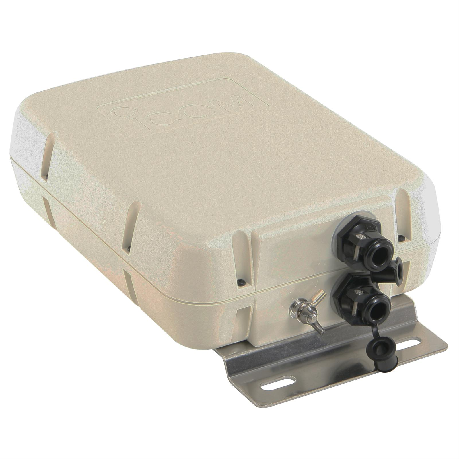

For a base radio I would at least get a radio with a built in tuner.
I agree with most of what you wrote, but for someone who wants to experiment with antennas, I suggest an external automatic tuner.
An internal tuner protects your final transistors, but may cause your coax to radiate under higher VSWR, and may result in high voltage on your coax.
With an external auto-tuner, located near the antenna feed point, you'll put more power into the antenna and less into the feed line, and you'll avoid high feedline voltage on antennas like random-length long wires, or on tuned antennas used far from their design frequency. These are typically weather-hardened, designed to be mounted outside, near the feed point.
If you're going to use a tuned antenna on the frequencies for which it was designed, a built in tuner is simple and works fine for matching relatively low SWR.
But for a beginner who is likely to have a random length of wire, nothing beats a feed-point tuner!
