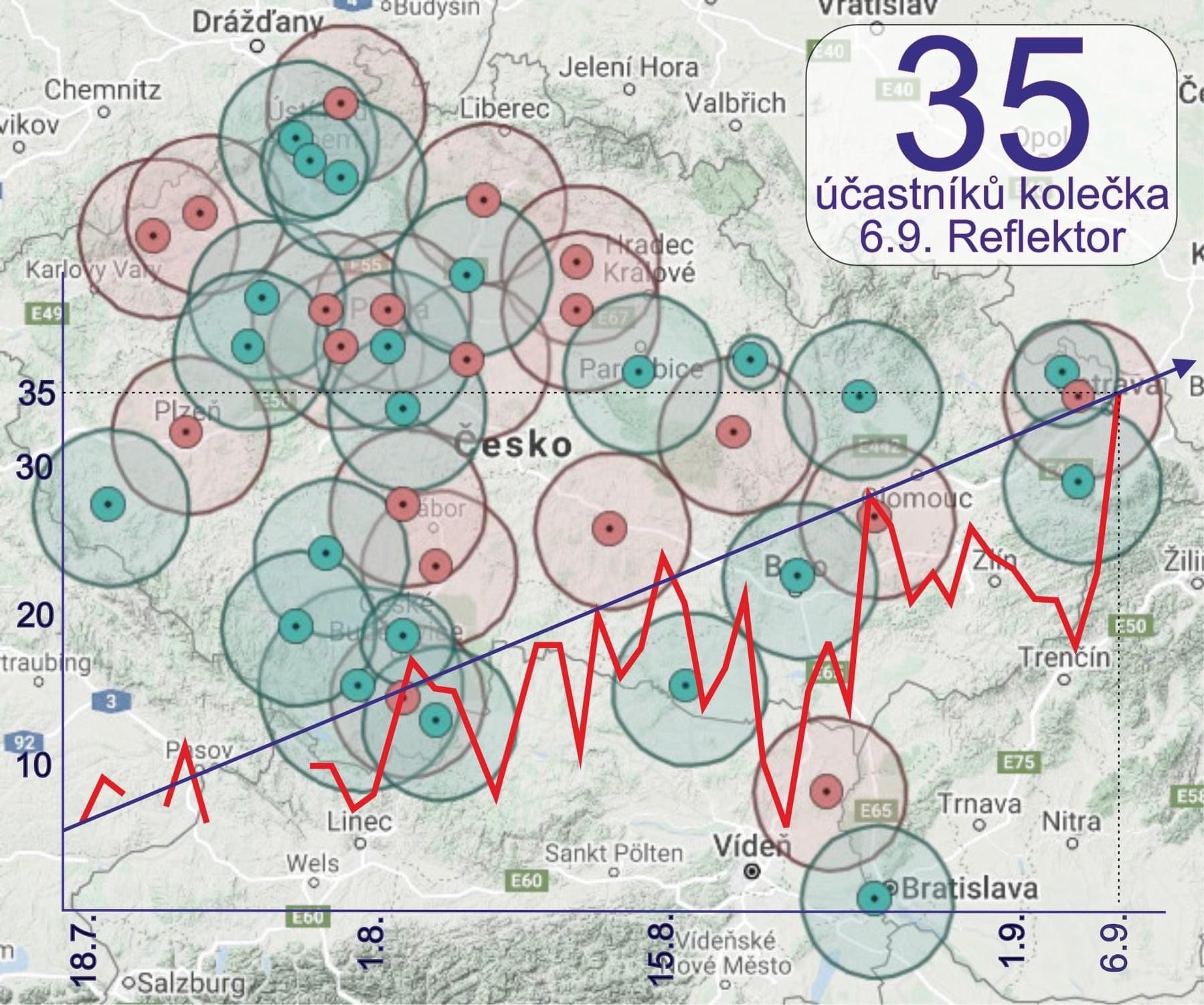

Internet-connected FM hotspots in the CB service are a thing now in the Czech Republic, according to Simon the Wizard.
https://simonthewizard.com/2021/09/11/czech-republic-cb-hotspots/
Amazing news from Skipper Kittsee arrived via WhatsApp about the Zello + CB hotspots coming up in the Czech Republic. The project is the brainchild of Jirka OK1OCB who we’ve featured back in July! In Jirka's own words:
"The project started three months ago as a simple way to connect two towns together via CB radio. When my friends tried it, they offered me many other QTHs for my hotspots. So i was making a new pieces for many days and nights and today we have 41 hotspots in our reflector network."​
They've got their country covered. Map below. The Czech Republic has the land area of South Carolina with double the population, or 10 million people. Helps that they have 80 channels in their CB service (like Germany) to keep the hotspots separated. They also use PL tone enabled squelch.
