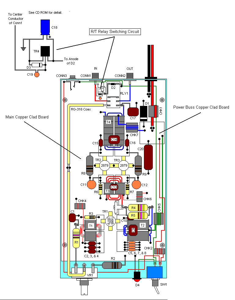

if i want to use the 2, 4 and mabye 6 pill amp schematics posted here, how would i change the values of the capacitors and resistors to match the hg 2879 regulars?
I normally start with 560pf on the input transformer and 1000-1150pf on the output transformer. Output tune caps 140pf-150pf input tune caps 120pf-ish. Variable caps really help with this then install fixed after you get the tune right. 10 and 100 ohm resistors stay the same as do the 120pf beside the output transformer. This is just a starting point!!!!!!!! This is why I only repair HG boxes, guess I am still stuck in the past. Once I run out of real Toshibas I guess I will have to step in the HG thing.
well i have 3 toshiba 2879 red dots, but i am scared to build with them. i have built 2 hg 2879 4 pills and fixed many other amps but i cant calculate the values of thing like that. but thanks alot.

thanks. one more question. where could i get a schematic for a 3 pill (1 driving 2) of toshiba 2879 red dots?
