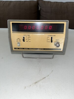

I think the HP5381a is a great starter frequency counter for CB radio work.
It will let you set things down to 1hz accuracy with a 1 second gate time which is very useful when aligning radios.
yes they are very old so they should have their electrolytic caps (three of them i think) replaced in the power supply section.
The big deal is to find one that is actually working. once the power supply caps are replaced there's not much that can really go wrong with it unless you misuse it.
they can be found on ebay for around 100 dollars and seem to always be available.

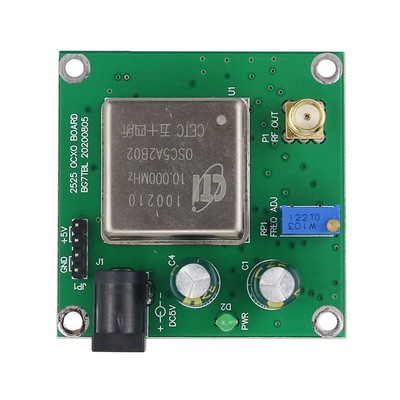

you'll also need to calibrate it, so you'll want something like this:
there are some specifics involved with powering this item but instructions can be found online.
