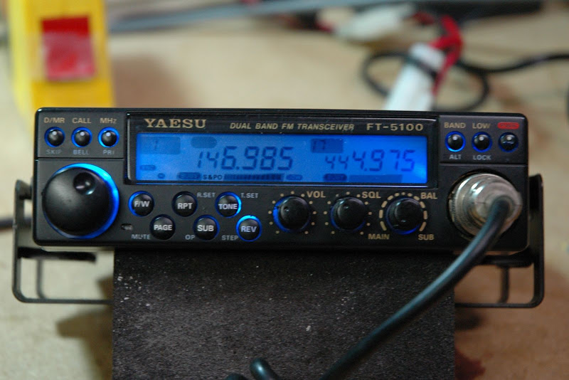

Bought this rig on the cheap at the hamfeast today. Backlights had all burned out, a relatively common occurance in this rig. Replaced with Blue LED's to give it a more modern appearance.
"Not too shabby"
Kind of hard to believe they stuffed all that stuff in a rig so small... And this thing was made in the early 90's!!!
This little dude does cross-band repeat, too...
Everything else works as advertised. These rigs are famous for the little bulbs going bad... problem is, most folks don't (or didn't) know you could dim the display from the front panel. (It is NOT obvious or intuitive...) If they'd have dimmed the display one "notch", they would never have had a problem.
Another thing they're famous for is getting REALLY hot. It is because they're just barely larger than an htx-252 and do 50 watts on VHF. Little tiny heat sink with an itty bitty muffin fan. Best bet is to run it on low power!!!
And just so we're clear, I DID NOT put a swing kit in there... tee hee hee.

Did that radio there you have use a standard 12 volt lightbulb or was it a crazy or odd voltage?
Could I have the specs or part number for the L.E.Ds? I have the same radio and my lamps are out.:headbang
Mine too....I'd probably stick with orange though.
Was it tuff to get to? I've just been too lazy to get into it.
I like the radio much. I think there was a fan mod of some sort.
