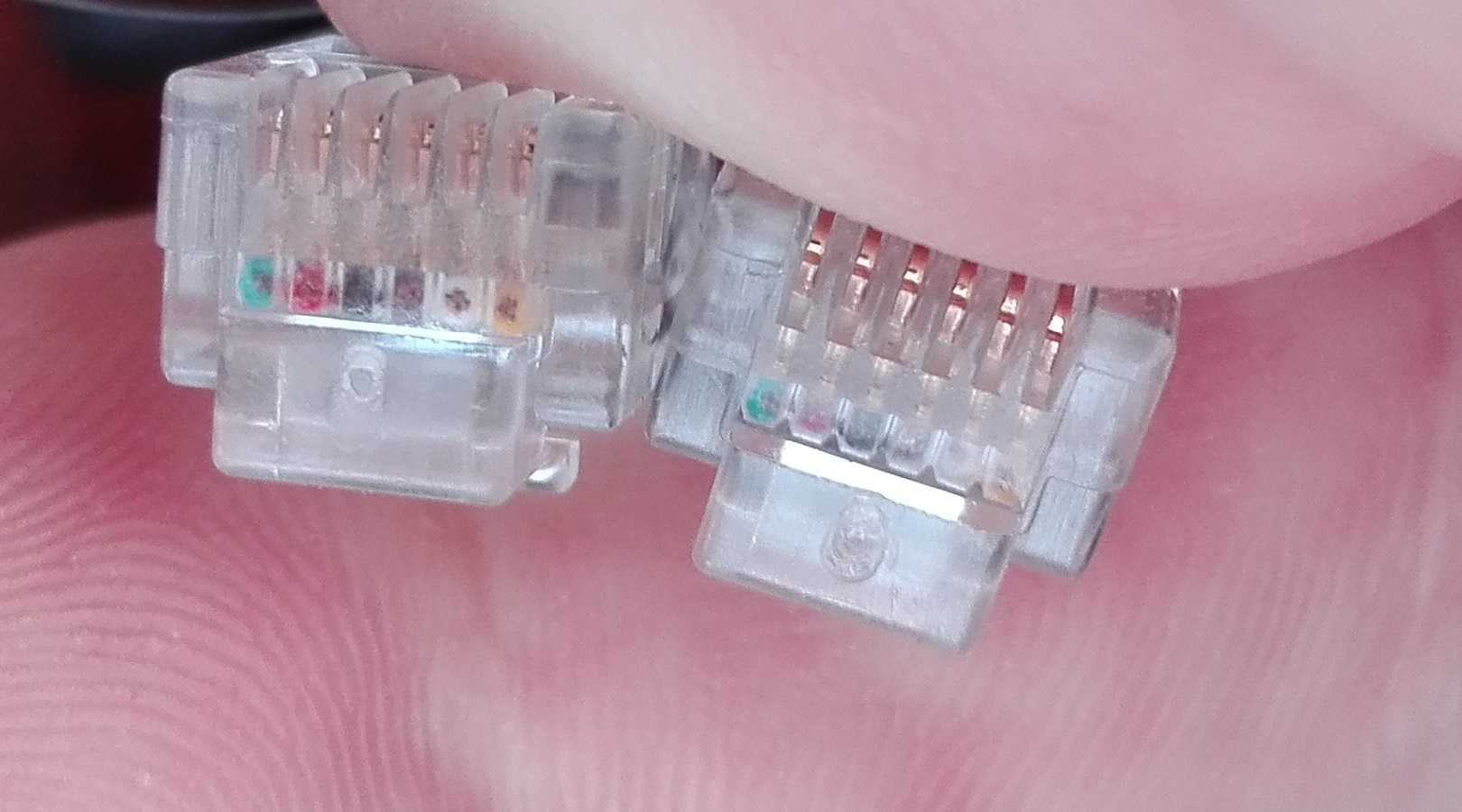

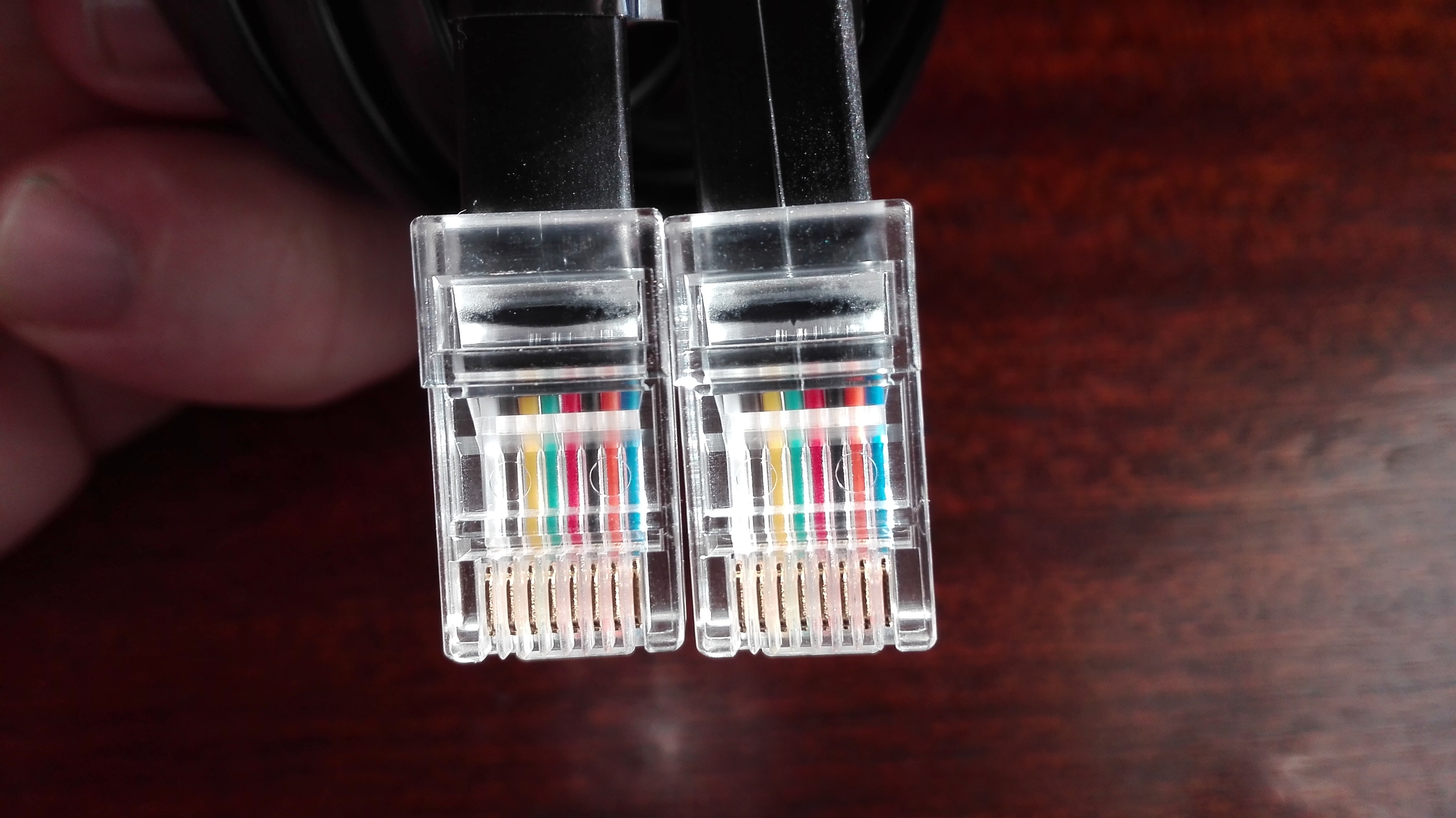

both RJ style cables in the kit
6 pin wires are not crossed over cable is normal round
8 pin wires are not crossed over cable is flat
