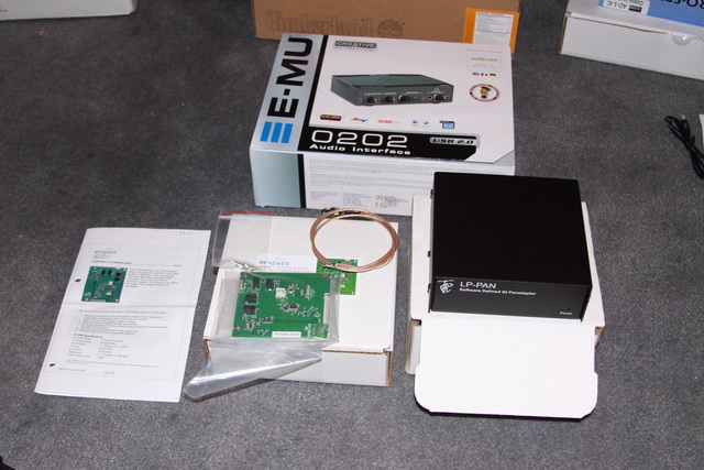

I got lucky and someone was selling a complete set up for the right price. This included the RFSpace IF-2000 board, LP-Pan Adapter by TelePost Inc, and a E-MU 0202 USB External Sound card.

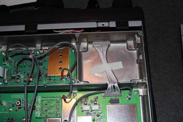

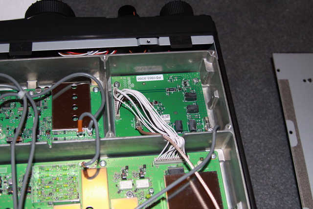

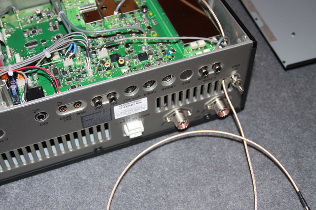

The first item was to install the IF-2000 board in the radio. This is a little easier on the FT-950, all you have to remove is the bottom of the radio. It mounts where the DMU-2000 board would mount and you route the output cable through the back of the radio. See Pictures:

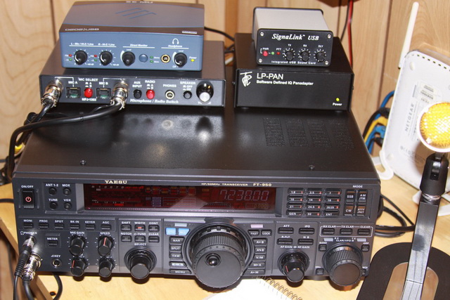

Next was to connect the LP-Pan and Sound card. The LP Pan has a BNC connector on the back that you just connect the IF-Output to, and two audio out ports that connect to the left and right in ports on the Sound card.
Everything else is software set up and that can be tedious and painful !!
I did manage to get the E-MU 0202 Beta drivers and the installed fine, however when I reboot the computer I hve to turn the sound card on and off a couple of times to get the driver to load correctly.

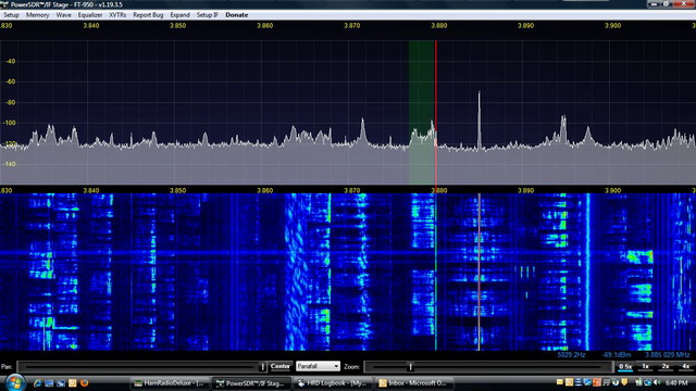

Once the drivers were working I installed the Power SDR-IF Stage software. There are only a couple of parameters that needed to be changed and everything was working perfectly.
I have reached my max picture attachments so I will continue on in another reply.

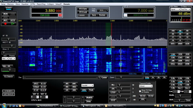

Ok a few views of the software, it takes a little time to get everything synced up between the radio and software, but it gives you a very nice view of the band. You can also plug in to the head phones jack on the sound card and use some of the many features of the software to make you listening much more enjoyable.
Here is a view of the main software window.
Here is a collapsed view with the Panafall display chosen.
