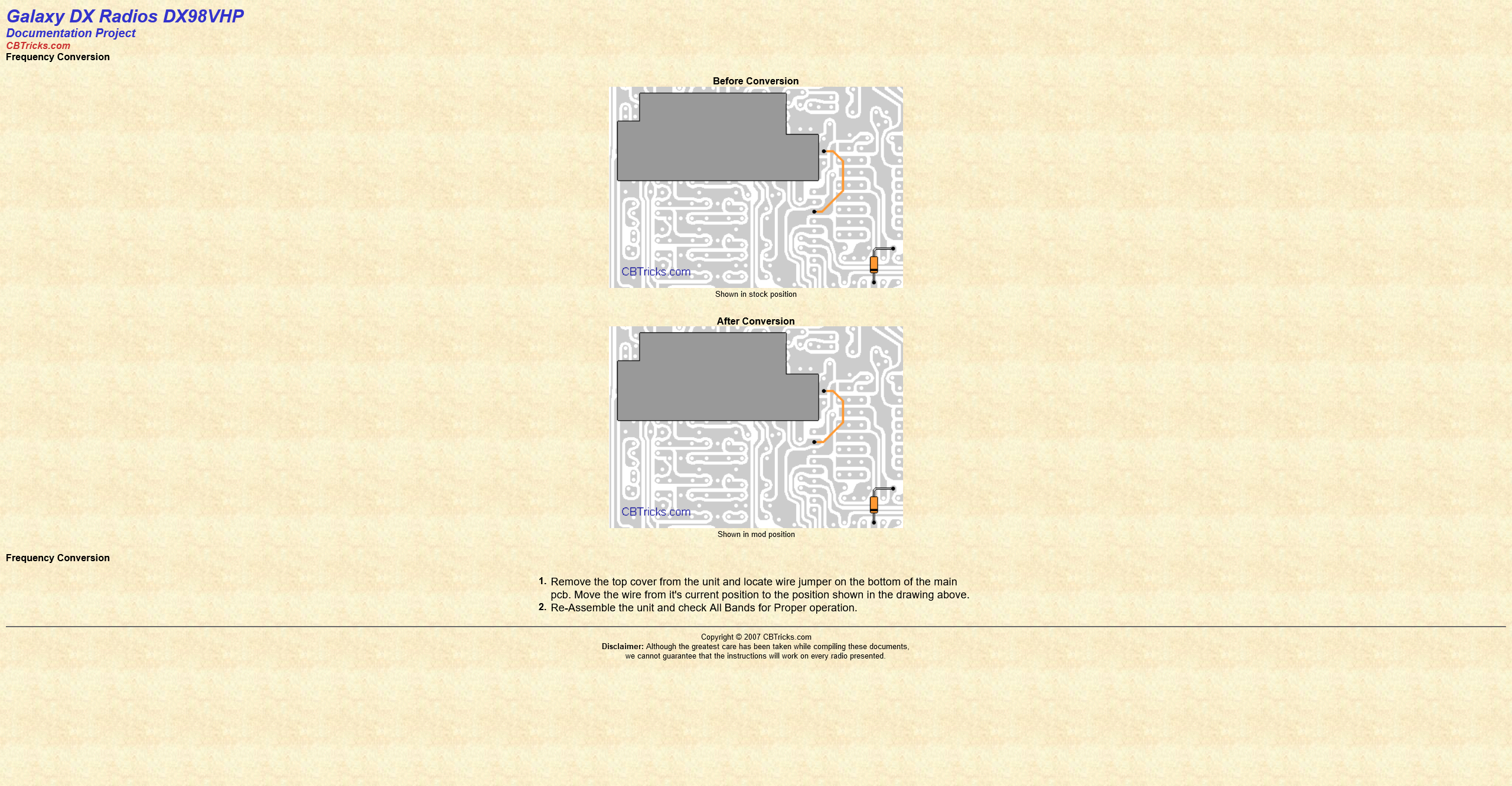

These are 28-29.700 or a bit more out of the box. SO the rigs go there. However when you do the 11 meter mod of completely removing the 4 Resistors - they top out at 28.775. I want to be able to still go to 29.700 or thereabouts and it's okay if I lose some coverage on the lower end. Has anyone experimented with just lifting the leg on one or more of the resistors to see what happens with the frequency coverage?
I'm wanting to do this: > as I enjoying working the 10M AM Portion at 29.000-29.200 (common) Would be nice to have an AM Audio Monster lol radio up there. My Icom sounds decent on AM ..... but it ain't no CB AM Audio Monster rig. Any help? I'm aware that the Strykers cover 29.000 as well as the RCI X9 and the RCI's. I used to have a 94HP but let it go. Would be wonderful to have a 98VHP with a 50 watt carrier and PEP to 200 watts up there. Think of the Audio Reports mannnnnn ..... just think of them :LOL: Anyway - I'm just trying to decide which high power (non-computer programmable) export mobile to get.
Also, I'm aware that if necessary, the 94/98 Resistor Set could be completely disconnected and hooked up to a 4 Pole Single Throw Switch to cut them in and out.

Isn't the conversion still done by moving a jumper wire?
If so, you could always wire up a multi-pole switch to go from between the 11 mod and factory.

Not on the Galaxy's. Maybe you're thinking of the RCI 29XX's
