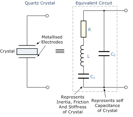

It's your focus on Pin 8 PLL that has me worried, for that output RELIES on the input from Pin 7 - it's not a pass thru, it's a buffered output from the internal amp used to clean up the Clock and let it get used by the system.
  • I find it ODD the Galaxy, along with others, do not use the output of this pin to help with signal and it's propagation thru the board, for many timing references use it, but they "originate" at other spots on the board.
  • This technique lends more to the notions that Galaxy is a Drifter, and rightfully so, 30 minutes of Warm-up - is sometimes not enough.
  • Part of this propagation effect is the required use of other Xtals for the mixing, but they too, when you look at trace lengths as well as the parts used to communicate these signals throughout the board, the inherited delays in the signal flowing to and being used by the other support "blocks"
    • - there can easily be self-induced PHASE Relationship changes to the arrivals of a specific signal at a given specific level of quality
    • - it's a self induced degradation I've seen the some of the best radios out there
    • - they purposely add trace lengths to offset this sensitivity by letting the trace (or cable), wind thru areas and land at a specific spot in both length of cable and location on the board
    • - and to think I get chastised for Coax Length issues, the techs do this to prevent degradation - go figure?
When you see your difficulty in adjustments - knowing you're going lower, the idea is to lessen the LOAD you place on it. Your tip is causing this along with the shielding - adds a complex impedance to the clock circuit - mostly as capacitance ACROSS the tip to ground.
It's why I wanted you to locate other clock circuits' the PLLs' in other CB's use to help you gain back control of your radios...
Each one uses the 10.240 signal to help with their IF imaging in some form. Usually as a mixer product to DERIVE the lower 455kHz IF image they eventually detect and amplify the Audio Envelope from the Carrier that finally after all the levels of processing - shows up as the actual signal you're listening for.
