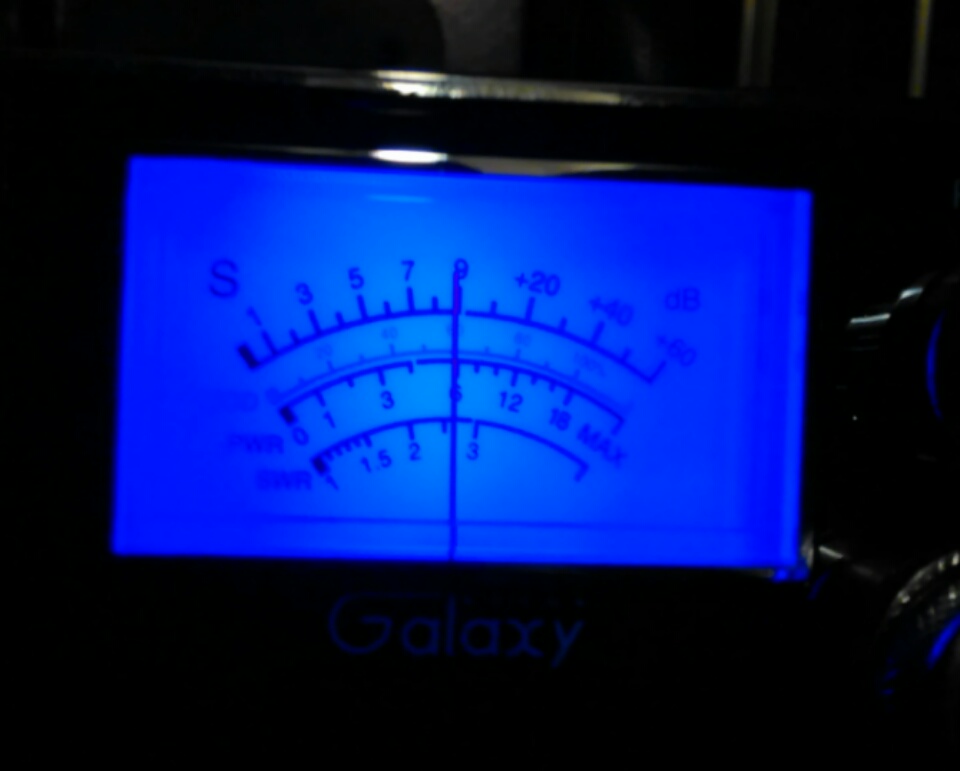

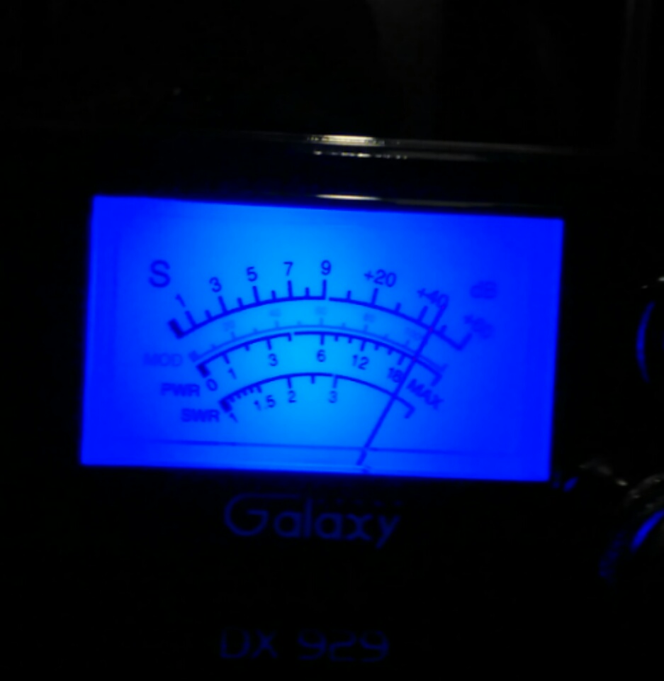

I got a DX-929 tuned/peaked up from CB world (wearecb) before they shipped it.
The internal meter is reading higher than it should for deadkey.
I get a 6w on lowest setting with knob and over 18w on 3/4 setting.
and the 18+w deadkey with the power knob turned 3/4 way up..
After checking with my cheap external Astatic PDC1 10/100 & SWR meter I am getting 3-4W on low power and 9-10 on 3/4 knob..
I am leaving it 1/4 knob and about 6w (according to the PDC1 meter) for now... CB Worlds tech is gone till Monday.. I left Chad a few emails.
I noticed on my friends DX-949 that just came in with my 929 that his does the same thing (more or less). The internal meter on his is 6W on low and over 18W on 3/4 knob..
Can anyone whom tunes these for a living please reply..
I just need to know if after normal peak/tune if the internal meters are off on the power/watt setting on deadkey??

I opted to follow cbtricks and turned up power knob on front on channel 19 with my 1.1 swr and adjusted VR9 myself to read 10w on front meter. Then backed off front power to lowest power and got my 3.5w. So the front meter now matches the readings from the other days testing. I set to 5-6w deadkey using power knob and will leave it be.
The VR9 only adjusts RF meter according to CB tricks and since the DK numbers matched my findings I am happy with results. Had 3 contacts tonight at 11-15 miles also.
