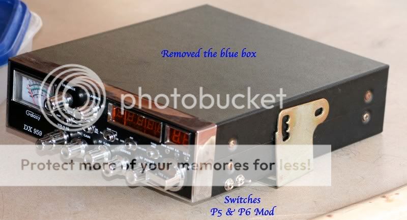

Im 1-5 (one five) from HI. Its a fine radio. easy chan mod and it comes with a freq counter, where can you go wrong..
heres some pics of where I mounted the chan switches. Had to grind part of the inner chassi of the radio to do this...
