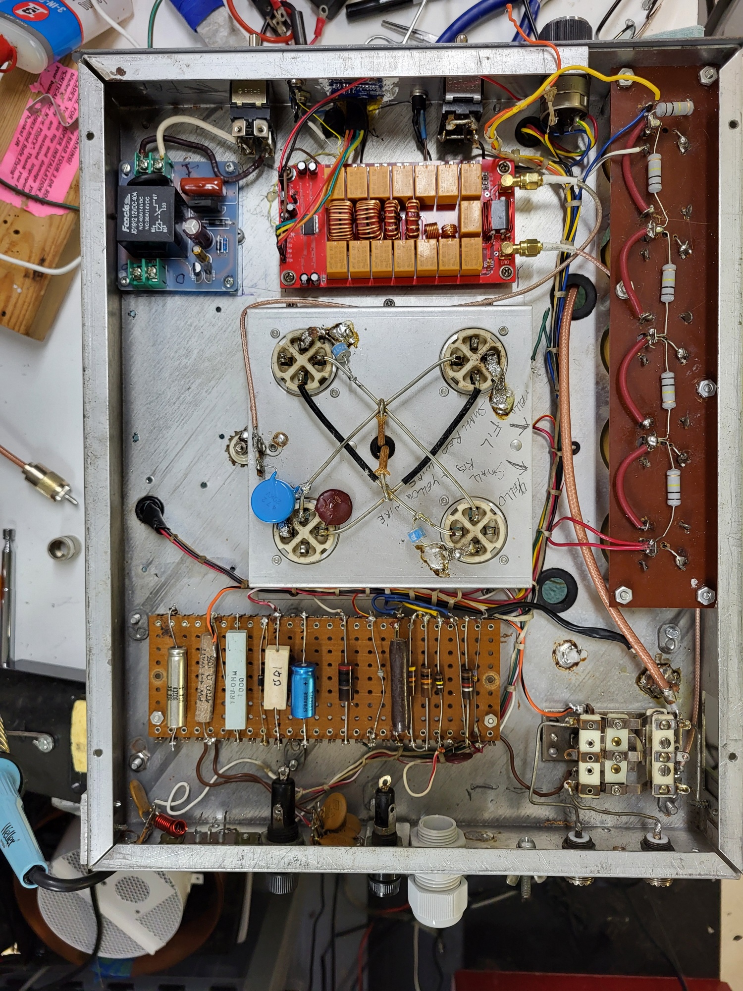

Progress is slowing down as Summer sets in and I'm overdue for an update. Even though there IS a/c , it's still too hot out there, so I really haven't done much this entire month. Anyhow;
I got the input tuner installed, and it works great!
The soft-start module is in-place, and the discharge tubes and new .0047Uf input cap are installed on the tube filament buss.
The OG real estate hogging perf-board circuit had to be moved forward 1" in order to provide clearance for the two fuse holders on the back.
All coaxes are replaced.
I had issues with the homebrew 12/24VDC, tuner feeding, bias-providing power supply's PCB mounting holes not wanting to be drilled-out wide enough (they all broke-out), so I have to re-mount everything on a new PCB, --- or find a store-bought module small enough for the only space left for one...... So more later on that.
EDIT: The pencil scribble on the tube sub-chassis is from previous owner(s).

Ivan, The soft Start is a ready-made module available on Ebay (here).
EDIT: I just checked, and that SS module I linked to here is DIFFERENT than the one I'm using (purchased in 2024 and, albeit, from the same dealer). When I just went back to check for it's part number, this one popped up. No worries, as either will fit in the same "real estate footprint" of the chassis, if the OG is no longer available.
I'll have to look again, but I think the "white substance" you're referring to is just white RTV that I used to cement the OG (but cut-down) filter capacitor jackets over the new caps. I did that to try to "maintain stock appearances", but given the "hack job" to get the input tuner installed and other "body work", it was sort of a silly effort to 'keep it looking original'...... Totally cosmetic. EDIT: Confirming, yes it's just 'glue'.

Hi, Steven. The input tuning is automatic as opposed to the standard manual bandswitching arrangement. And it's provided by a cheap, over-the-counter automatic tuner called an ATU-100, designed by N7DDC and is "open source". These can be purchased pre-assembled, or in kit form. It was a little tight getting it in there, and a Dremmel tool was involved :rolleyes: --- but it really worked out VERY well.
