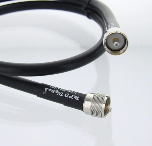

Honestly, your best bet would be to spend a little more money and get a good 5/8 wave American made antenna. Imax2000, or now it's called Max2000 would be a great base station antenna. Connect your antenna to your radio with some American made RG-213, or LMR400 coax. The antenna comes tuned for CB channels, and has tuning rings if you wish to deviate from the CB band slightly.

2 18 ft pieces of 8x? change that coax to a 213 or 8 something bigger an better without a splice,,,
