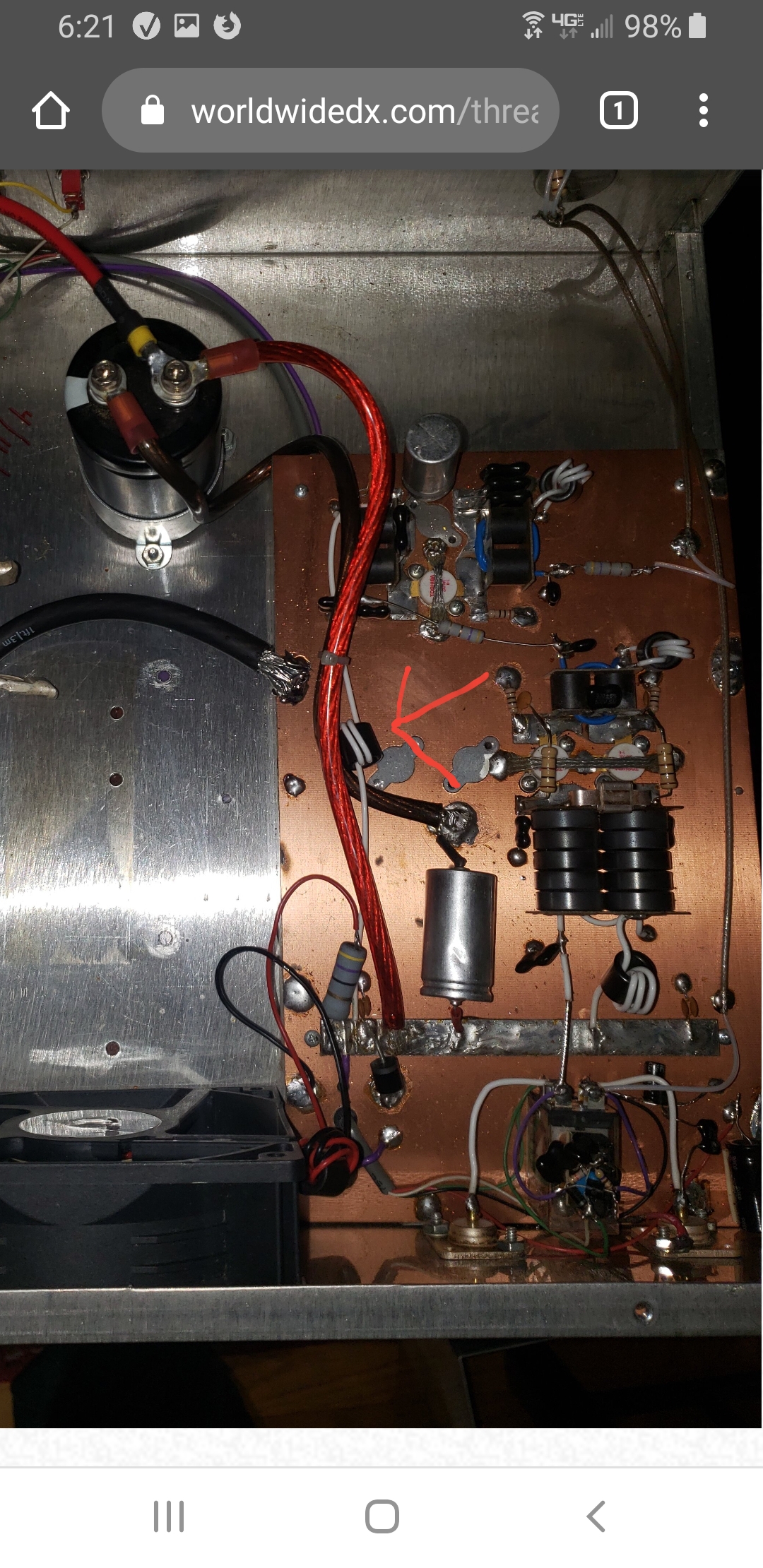

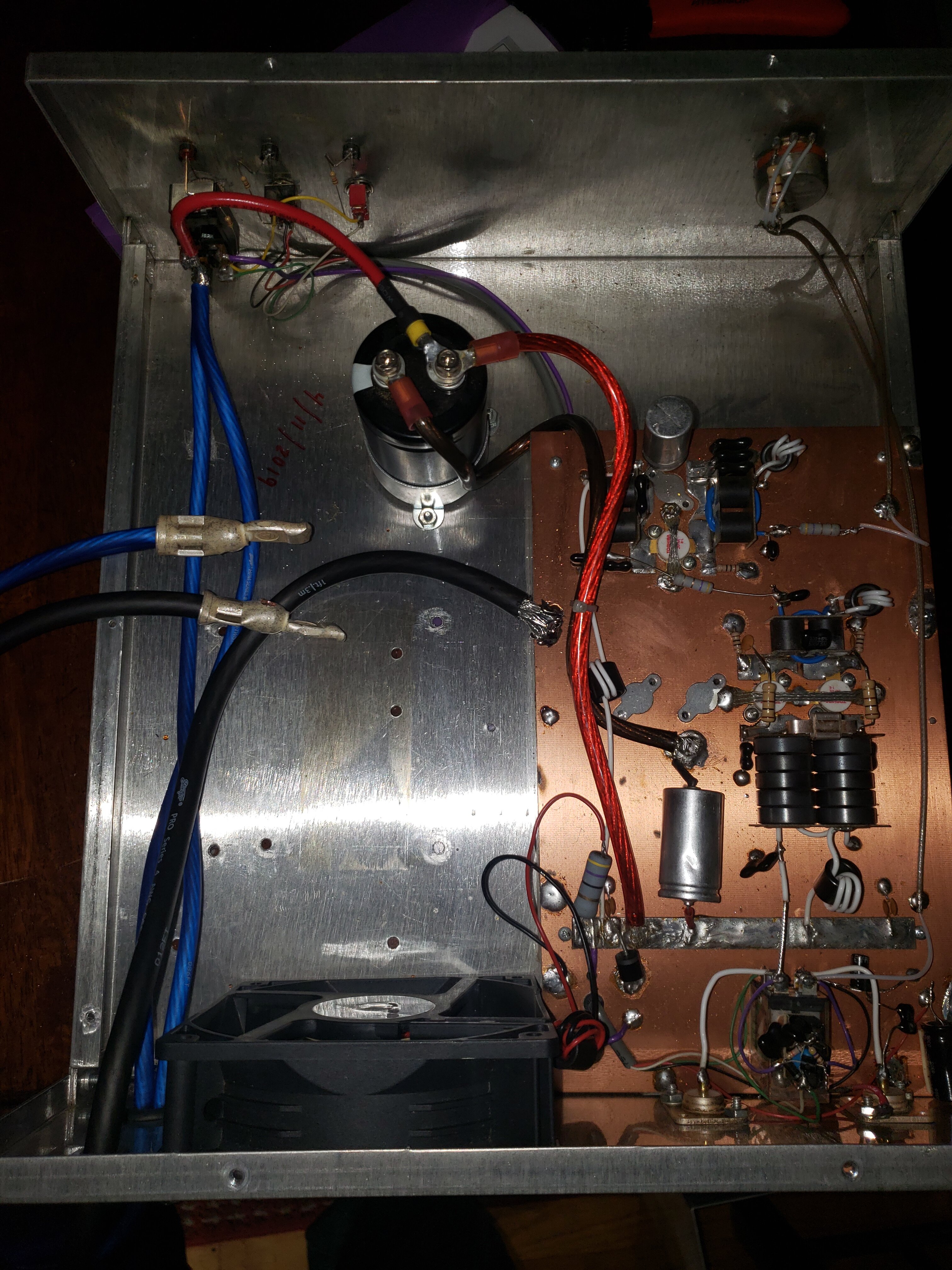

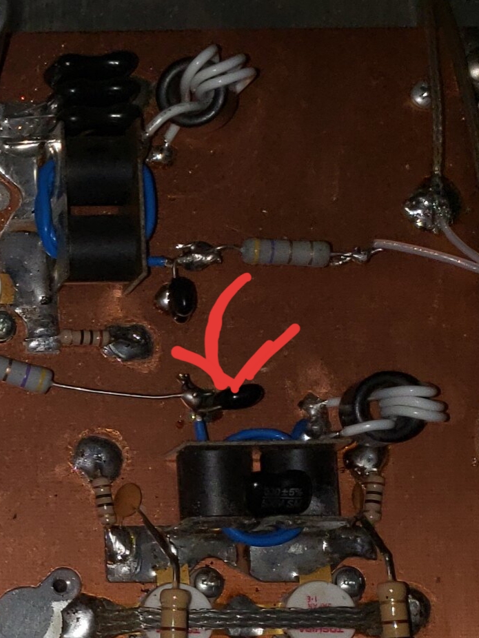

So i won this in a raffle for 10$. Its in good shape seems the tranaformer crapped the bed and was made into a moible. I did up some new power wires and a 150 amp anderson.. go to key it up and 0 output haha my luck,so before i start pulling transitors and testing them on my dca 75 can i just remove the power to the driver section to disable it? I just want to see if it will chooch out any steam from the 2879 section before i rip the pills out.
No. That will disable the whole amp.
You need to move the RF input from the driver section to the finals.
Ok great thank you..i thought just pulling thr positive to the drive section would bypass it. Would i need to link it to the resistor coming from the 1 pill stage or can i just run it direct to it.
Thanks
Chris
Also remove the white power wire with the ferrite core to the driver. It probably won't hurt to leave it in but there's no reason to supply power to an unused transistor. Who puts straps actoss the emitters on a copper board?
