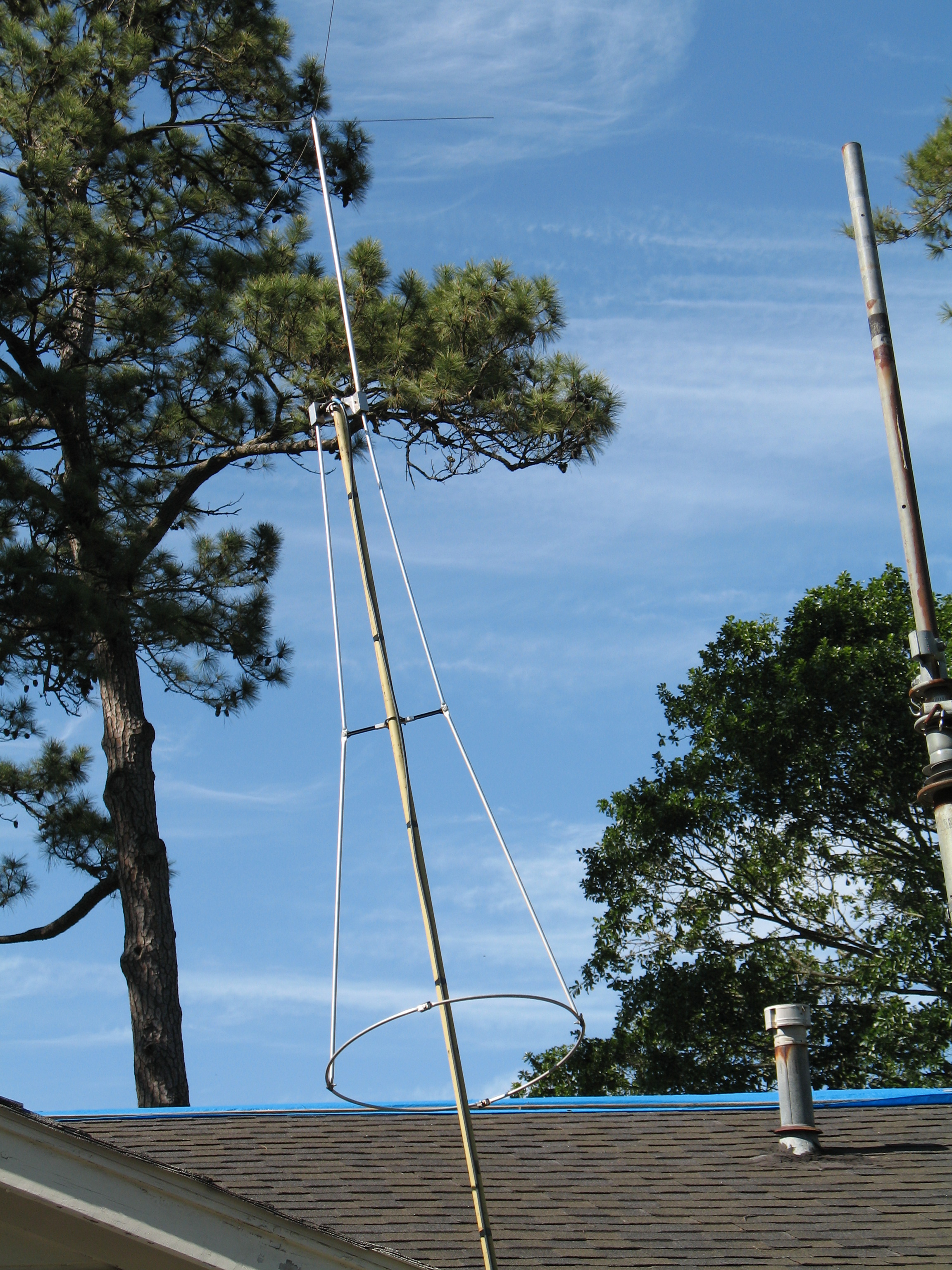

I did notice some directional qualities, but it might have just been attenuation to the north direction (opposite side of the roof) instead of actual directional qualities. I saw this with an Astroplane and a Starduster type vertical I built, both on 20' mast leaning up against the eve of my home. The antennas were just too low.
See picture of the AstroPlane about 4' from the roof:Astro Plane leaning against roof & didn't work.JPG
Off hand I was not aware of much effect on the tuning, but I'm sure there was some. Until I got th base of both antennas well away from the roof and at least above the peak at 18' neither antenna performed well to the north, the opposite side of the house in the picture. I could even detect the affects as long as I had the antennas close to the house and raising them up several feet above the peak. The real improvement came when I move both antennas further to the back of the yard away from the house and into the clear and even then the antennas were attenuated to the north if the bottom elements were even with or below my roof peak at 18' high.
I don't know what experience 'Doc has on this subject, but I tested the condition. It did take very close observations though and I did not see a night vs day difference, so if I was wrong, then old 'Doc is probably right that being 2 meters away from you roof probably won't make a bit of difference---it not being made of metal and such.
