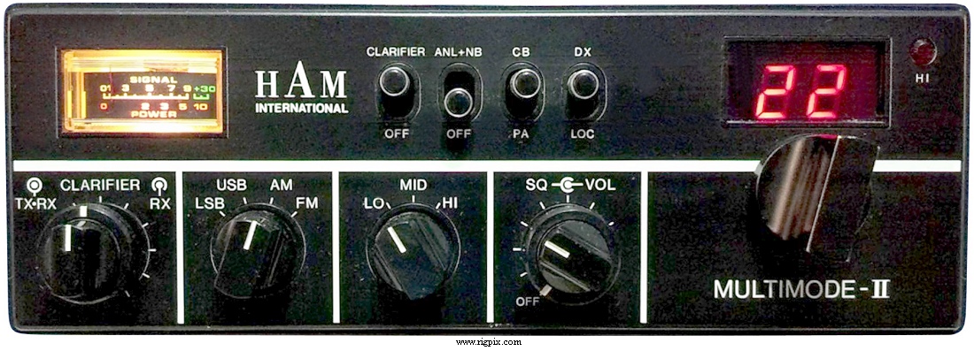

Just had this donated by a guy at work, turns on ok, TX/RX no problem until you've been TXing for 2-3 minutes then radio goes silent on am/fm/ssb. No RX or TX, turn the radio off, leave for 10 minutes, turn back on and radio works fine again. You can listen to the radio without TXing for about 15 minutes before the fault appears again. Seems like something is warming up or possibly overheating. Anyone any ideas about this intermitant fault?

The problem is no doubt heat related to use. Doubtful it is the PLL unless you have already back-tracked it to there. Get a can of compresses air and start spraying each part one at a time until it comes back on - sounds like a transistor that is thermally compromised. Check other parts if the transistor checks didn't solve the dilemma.
Doesn't hurt to look for iffy solder joints on the trace side of the board either.
Dull grey joints are possibly cold solder joints and can possibly be affected by heat too . . .

It's not a 2m radio. It is a CB radio of sorts.
