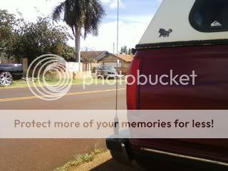

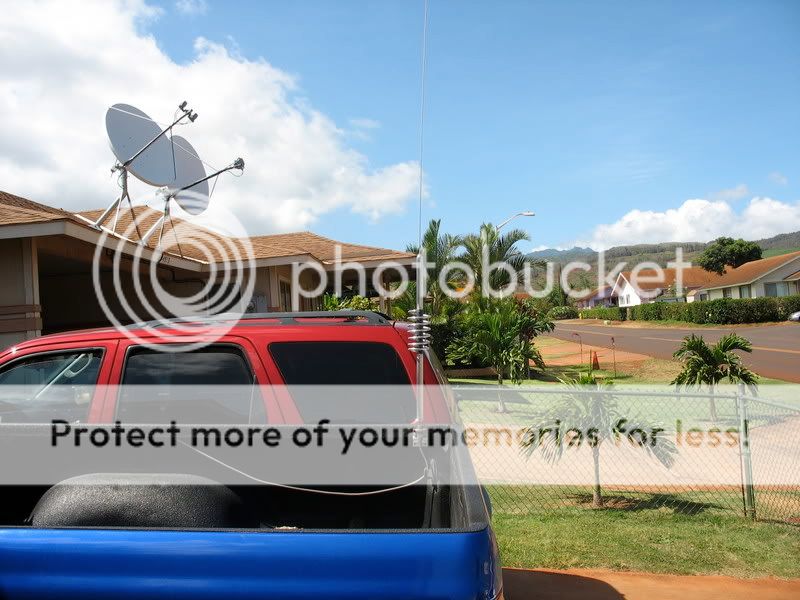

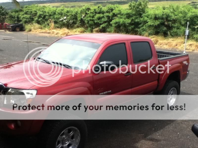

If I mounted the 102" whip on the back bumper, or in the bed would it be better than one of the Wilsons? Is their a small linear amp you would recommend that is reasonably priced? Is their a better mic than the 2018 that you would recommend? Thanks for the help.
An antenna that below the highest point of the vehicle is being compromised. I would NEVER mount one on the bumper. I run all of my antennas on the top of the roof - where it uses all of the vehicle below it to propagate the transmission efficiently.
The bumper would workgood or the bed railing.Just get some heavyduty mirrow mounts for the bedrail and a ballmount for the bumper.
