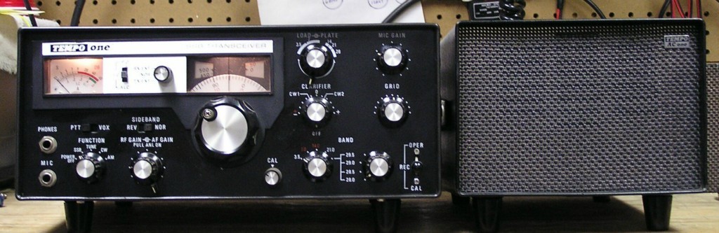

My Tech has a Tempo 1 for $350 is this a good rig? Or are they known for issues? Thanks in advance
Tempo 1's are not bad little rigs...There were a couple versions Whiteface/Blackface...The Blackface are the new versions...Remember this is a tube rig. There will be learning curve in tuning her up for each band until you get use to it.
They will do about 100-125 watts on each band.The receiver is not bad either.
Good Starter rig IMHO...All the tubes are still available and they are not bad to work on if something dies.
Few items...Did your guy just go thru this radio and it is in good working condition on all bands?
This rig has a external Speaker and Power supply combo...Good working condition?
The $350 price tag it should Look Good and Play 100%...
Had many of these over the years...
One other thing...Does it have the 10m crystals INSTALLED...Those radios worked on 11m but you had to remove the 10m crystals and retune those stages...
I would say check this in most cases as the 10m section is a must for Tech/General operation.
My 2 cents worth
All the Best
Gary

The crystal is moved to 11m..yes Temp has been recapped and tubes checked

Indeed. I expect one could find a TS-820 for that price and I would take it any day over a Tempo-1. LOTS of good older stuff out there for $350-500.
I consider it a criminal act to modify a TS-820/830 for 11m and subject it the usual abuse suffered on that band. :(
Me too, Captain K. I read about people reversing the process on the Yahoo hybrid forum, and it's a painful process. Only reason I mentioned it was the OP said the Tempo had been modded for 11 meters,.and I thought that might be a deal breaker for him.
73,
Brett
The first radio I used as a ham in 1975 and went on to work 205 countries with it, but that was on hell of a great sun spot cycle to boot. For the time they were a great little rig and the only drawback now is 8950 tube that it use is hard to get and expensive.
