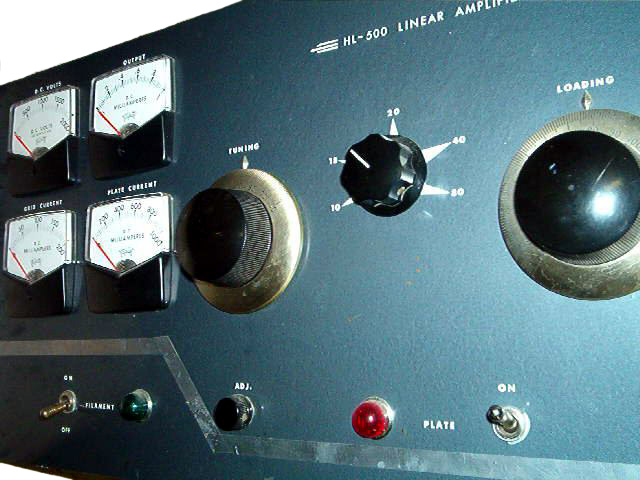

I had a Hammond HL-500 years ago which ran 4 811A's, and it ran about 700W (+/-) output with a 100W dk. I also drove it with a Yaesu FT-7 which ran 20W PEP and it drive it to about 250W +/- output (average).
