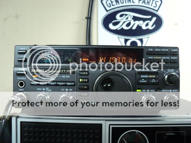

Hi everyone, I bought a Yaesu FT 890 and FP 757HD a few months ago,
