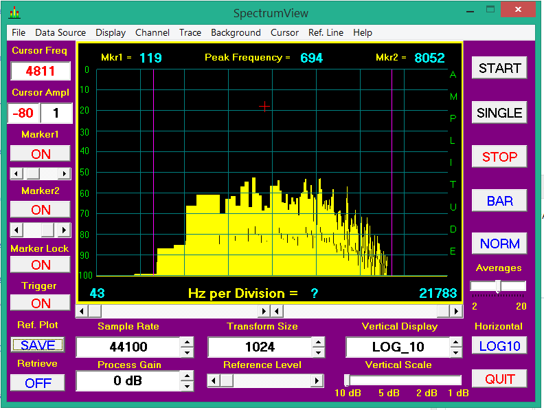

Scenario #1: White Noise
This provides a good baseline of the frequency response of the receiver simply as it picks up white noise from the squelch being all the way open. As you can see, the bulk of the spectrum appears between 119 Hz (marker #1) and 8052 Hz (marker #2). This nice broad response helps explain why I'm able to detect even minute changes to the EQ between 100 Hz and 6800 Hz.

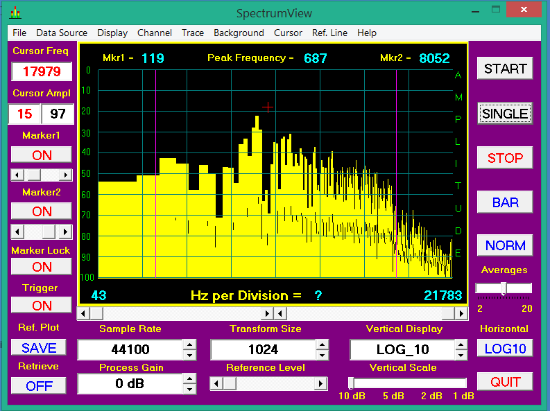

Scenario #2: Unprocessed SRA198 Noise Cancelling Mic
This provides a good depiction of how the radio performs with no processing whatsoever and a stock noise-cancelling mic. You can see that the 2950dx certainly is capable of pushing audio well beyond the pass-band limits of 300-3000 Hz. However, it is certainly more of a "peaky" look in the middle with a more pronounced roll-off on the outer edges.

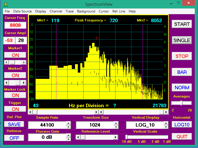

Scenario #3: Processed w/ Mixer/Compressor/EQ & Pyle Dynamic Mic
Now this is impressive. The bass response picks up dramatically, the outer fringes of the highs are boosted reasonably and the overall response in-between has risen in amplitude and flattened out somewhat; certainly less "peaky" than the prior screen capture with no processing involved. Is it truly "Hi-Fi" broadcast grade AM with 10 Khz bandwidth? Well no, not quite. However, it is certainly far better than the oft-cited "300-3000 Hz" figure that is thrown around frequently. The only down-side is that I can't perform this type of analysis for SSB signals. I don't have a second SSB transceiver to check the receive on. I can only assume that some of these improvements will translate over to SSB mode based purely on reciprocity and positive feedback reports from other operators.
It's not so much "thrown around" as it is a published figure that gets repeated. But I don't think anyone would argue the skirts aren't far wider than the filter specs.
