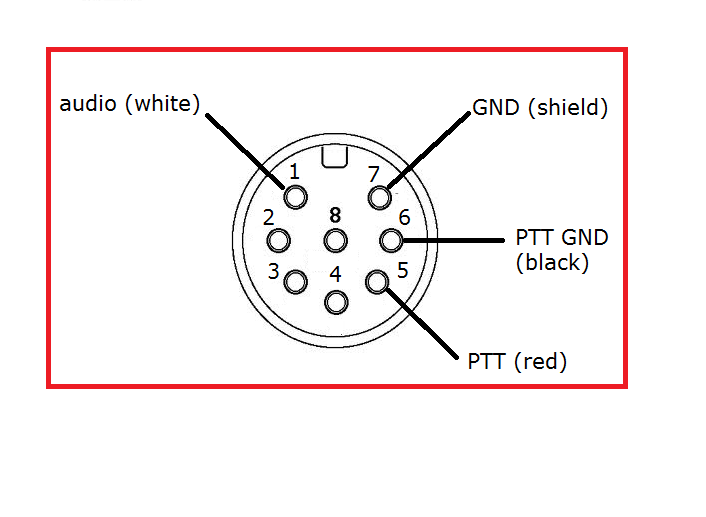

It should hook up like this. Colors are for the Shure mic cord

Your most likely correct 399...ICOM uses many configurations...sometimes Pin 1 or 2...sometimes more than one pin has voltage......
Here's a good link to identify many specific models...
Never used the 718...So my bad for not checking.
I have known op's that have caused damage to their ICOM rigs and/or mics trying to make hook-ups...
