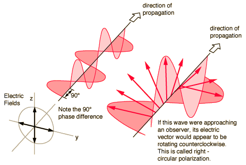

One can convert a dual polarized beam to a single cable by building a tuning harness. This will change the beam into 'circular polarization' by allowing both polarizations working together with a 90 degree phasing difference; some loss of signal strength due to cancellations will be a consequence. But it will also allow for all signals whether they be vertically or horizontally polarized to be received/transmitted with using one single feed cable. At least, that is how I have understood it.

However, to answer your question: You can use two seperate cable runs as 2RT307 discussed. Or, you can use both simultanusly and have Ciricular Polarization. (This is something used by Hams at 2 Meters and up for satellite communications to overcome satellite tumbling.) This requires a special cable harness that I could dig up if your interested. Two other thing to consider: Do you want Righthand or Lefthand Polarization? If you transmit with Righthand, then the receiving station needs lefthand, or the other way around. Also, consider that circular polarization reduces power by 3 dB (or half) since power is split between the two antennas.

Circular polarization - YouTube
I would double output power and plus,a CP beam antenna designed right can have significant gain figures
Sorry, you will not double your power. And a CP antenna will always have less gain than a non-CP antenna of the same configuration.
