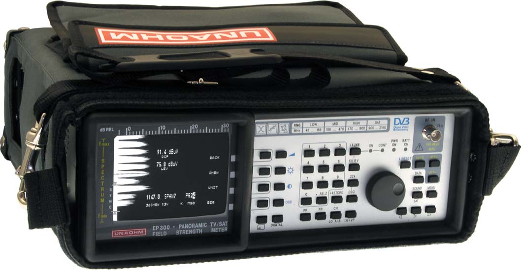

All this talk about field strength reminded me i had an old meter my mate gave me a few years ago buried in the shack so dug it out ,
Its no HP not even close but it seems much better than any of my vhf/uhf radio's s- meters,
Been playing with it yesterday using a short telescopic whip antenna listening to FM vhf radio,
I can see signal strength changes waving my arms around in the air close to the antenna a couple of tenths of a db,
Its a 45 - 2150mhz unaohm ep314, This ep300 looks the same,
http://www.dxsatcs.com/sites/defaul...asurement receiver with QPSK and NIT card.jpg,
Can't say if i will get around to trying it or not, i wish it covered 27mhz.
