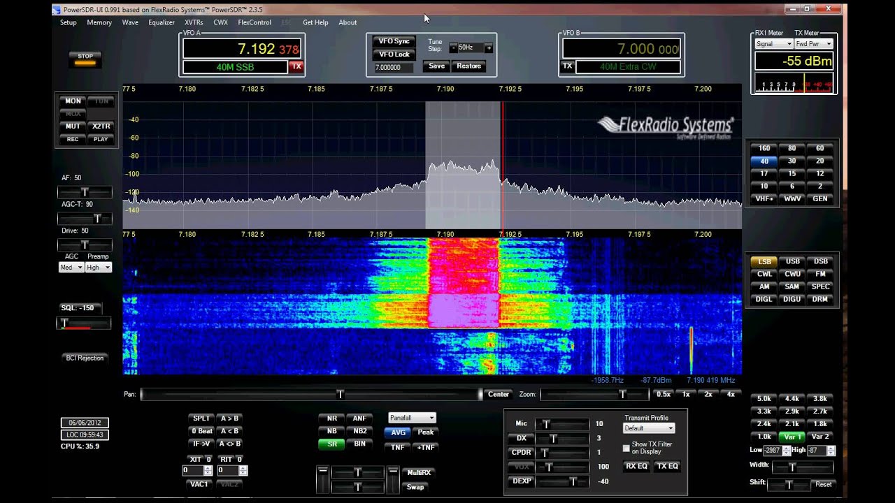

And in the meantime they've got a signal splattering 30kHz wide whenever they transmit. I've watched these people on a waterfall on my Flex 6500 and not one of them has had a signal that is narrow enough to fit in a single channels bandwidth.
I shouldn't be the one who is ashamed because I can get good quality audio and stay within the bandwidth limits of the band, the RX bandpass filters of those listening to me and channels I'm using unlike you and 99.9% of these halfwits.
Here's a signal from an Italian amateur who is infamous over here and who has the kind of audio you want. His signal is over 10kHz wide
I think some of the people that do these high fidelity modifications do not care that they are exceeding 10kHz and splattering on the adjacent channels, "as long as they get most of that audio on channel." It's a little different than the guys just clipping limiters and splattering on multiple channels for a crunchy distorted sound they consider "LOUD".
