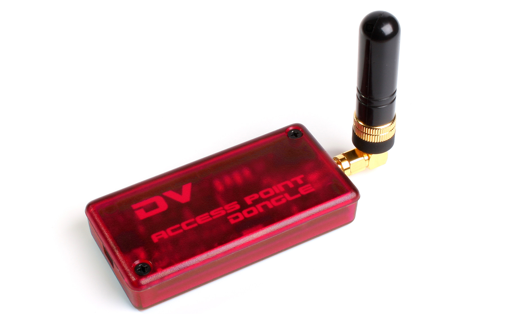

One D-STAR access point product available is the DV Access Point, also from INet Labs:
This device is a 10mw 2 meter simplex transceiver that plugs into your PC or Mac to communicate with a D-STAR gateway. The low power is enough to allow you to walk around your house with a D-STAR HT and access other repeaters over the internet. It's price is approximately $250.

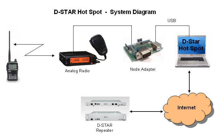

Perhaps the most flexible and interesting way to install a D-STAR access point is to build your own. To do this, you need three things: A node adapter board that you either buy or purchase as a kit, some free software running on a PC, and a regular VHF or UHF radio.
The node adapters typically cost around $100. The nice thing about this approach is that you can re-purpose an existing VHF/UHF radio and turn the node on or off as necessary. You also have the capability of much farther D-STAR range because of the infinite antenna configurations and higher power capabilities.
There are three common D-STAR access point node adapters available:
Of the three, the Matrix Circuits board is the only one that is completely pre-built. Of course, you could always make a completely portable D-STAR hotspot to take D-STAR coverage with you using a notebook computer and WiFi access.
K6JM has very thorough instructions on how to build and configure your own D-STAR hot spot at DStar GMSK Node Adapter Hotspot Setup. You can even build a simple repeater using one of these node adapters!

All three of the node adapters I posted use firmware from Dutch*Star that is typically included with the purchase of the board. This firmware is what handles the codec. The software that is used for the gateway and also manages the board and analog radio is free. There are few to choose from, as well. These solutions are all much cheaper than paying for Icom gateway and repeater solutions.
