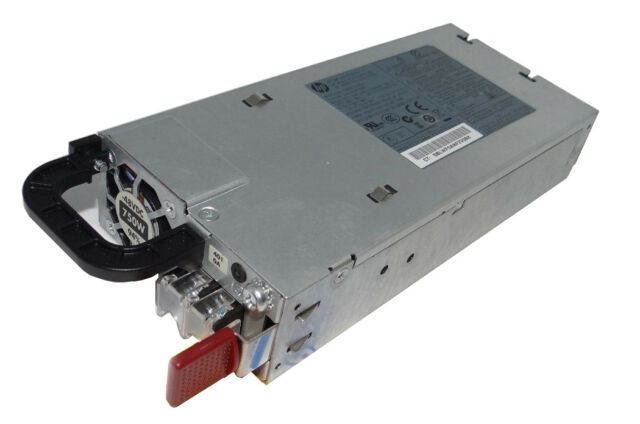

After a couple of weeks doing some research and watching videos I ordered an hp dps-1200sb to modify for high amperage gear (kl-503, 2970N2).
Cheap, easy to modify and work well according to sources. A couple of resistors and voila, so I hope! I'll photograph and document to share with others.
Hoping to zero in a variable 13.8 to 14.8 volts with about 70 +/- amps.
Credit to Mr bbi, Rainmaker Customs and 767 CB for doing the work and making it available to us Radio heads!
Above link is the one I bought that should be here Saturday.
More to come
The DPS-800GB's run really quiet. I put this one together (in a hurry lol) for a friend, still have the other one it was paired with in the shed with the power combiner board they plugged into.
DO NOT DRILL INTO THE FINGER BOARD TO ATTACH POWER POSTS, supposedly, there are buried traces inside them and drilling can screw them up!!! I folded the copper strap over the finger board and soldered it to both sides.
The sources named above have done some really good reviews and given really good suggestions so I'm hoping for good results. I'm going without the breakout board and will share the results.

I'm back to this one again so that it can power the amplifiers that will join the station soon.
So, I've done quite a bit of research since i started this endeavor and I found many suggesting 15k and 15k so that's where I started. I didn't achieve the 13.8 to 14.? but instead got 14.3-14.8. I'm contemplating whether to leave it or try some changes.
The amperage testing is still to come.
This stuff is super small so it isn't for the faint of heart.
I'll post pictures for others that might be venturing into this same territory.
More to come
