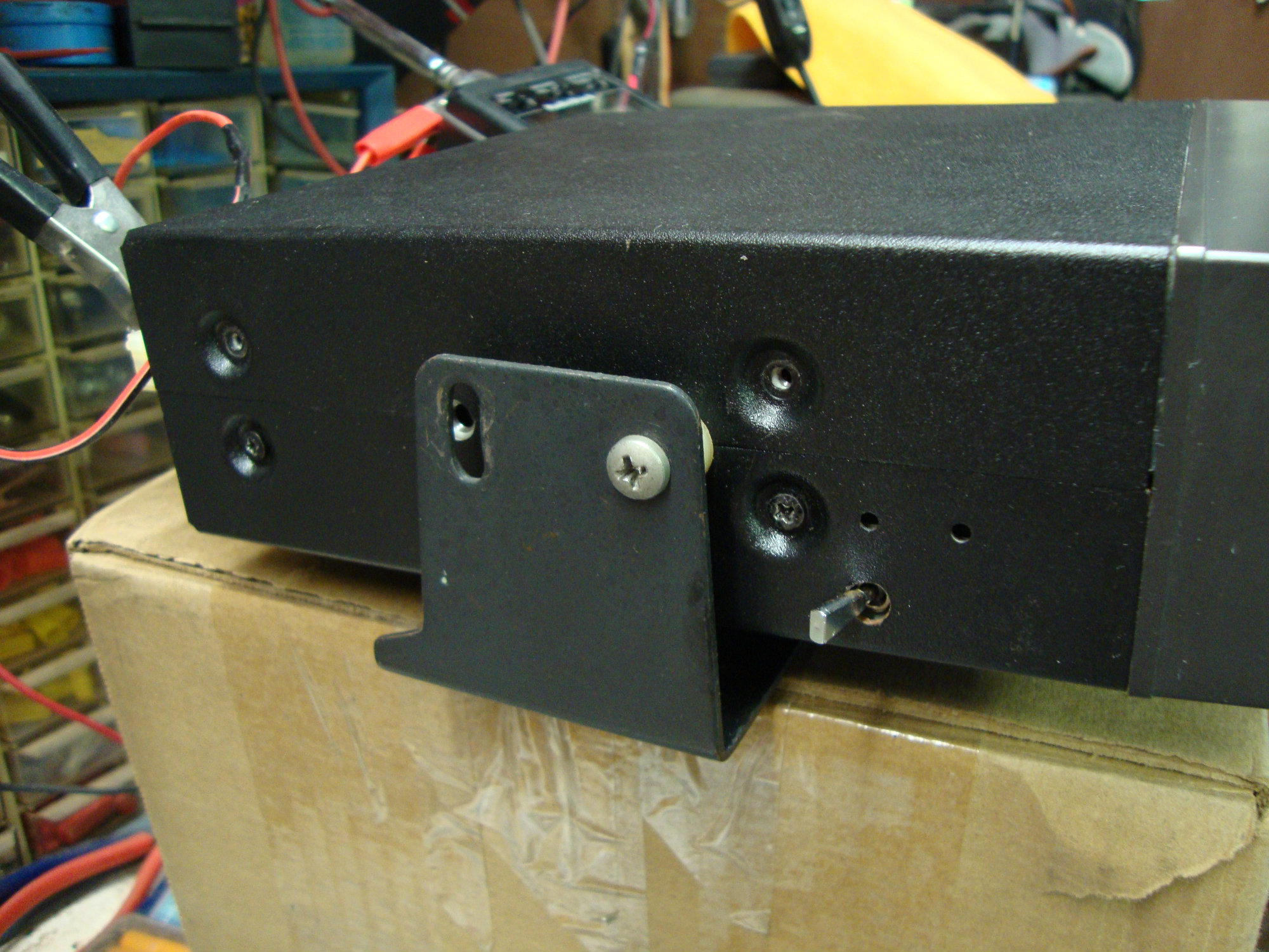

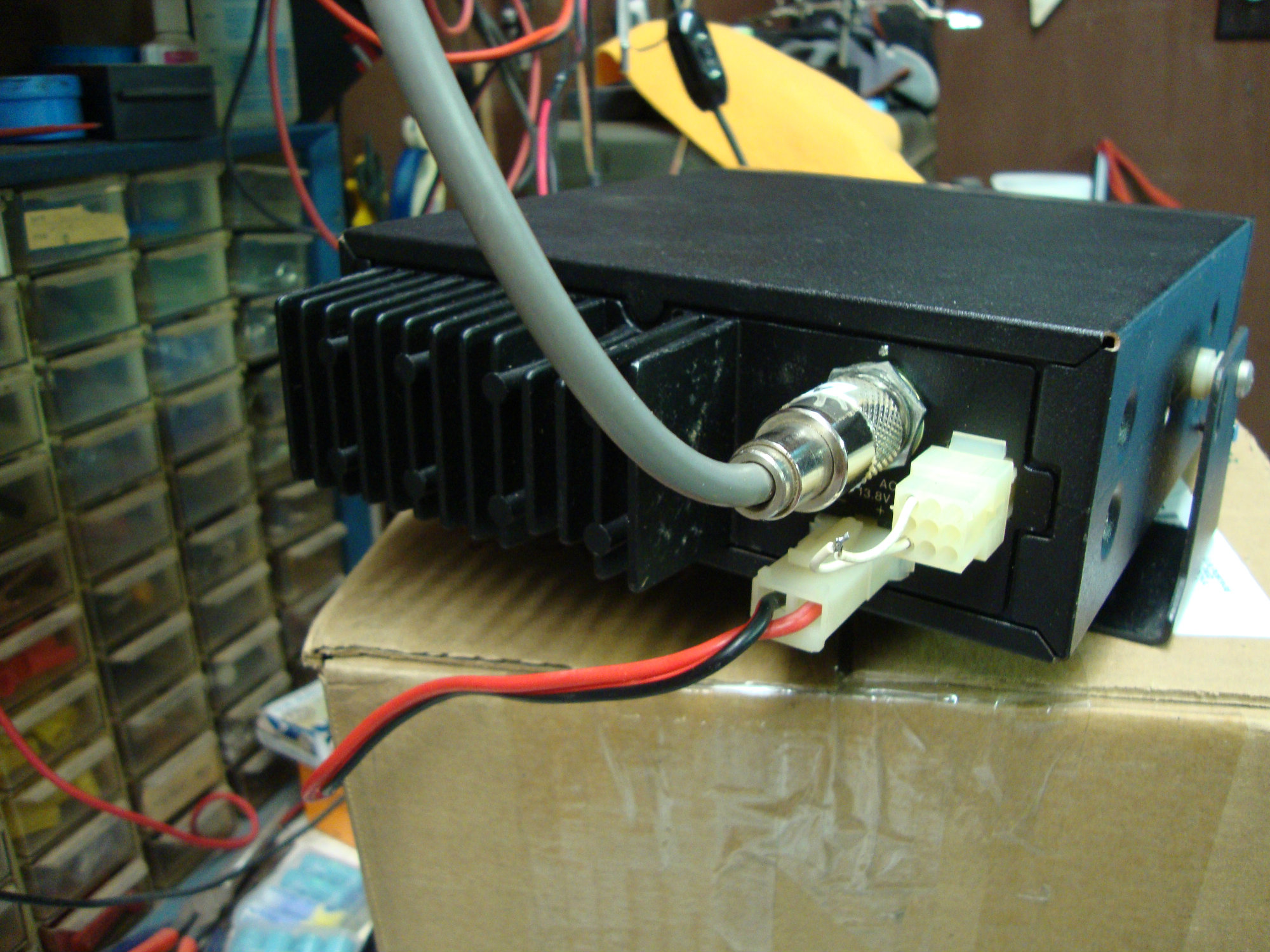

Radio has shortish factory power cord and the Accessory Plug is present. It has a mounting bracket on it but it is not the factory bracket. Only 2 of the mounting holes line up. You would probably want to obtain an exact fit bracket if you wanted to take this rig mobile. Radio is very clean and looks like it's never been mobile. Only has a few little 12600.jpg paint dings in the top of front bezel but otherwise is very nice. Front panel is perfect. Factory hand mic looks like it wasn't used much - super clean. Up/Down buttons work. All button functions on front seem to work as intended and I did myself have a 2510 for several years back in the '90's. Rig sounds good TX & RX with many local contacts! Onboard speaker sounds fine as should.

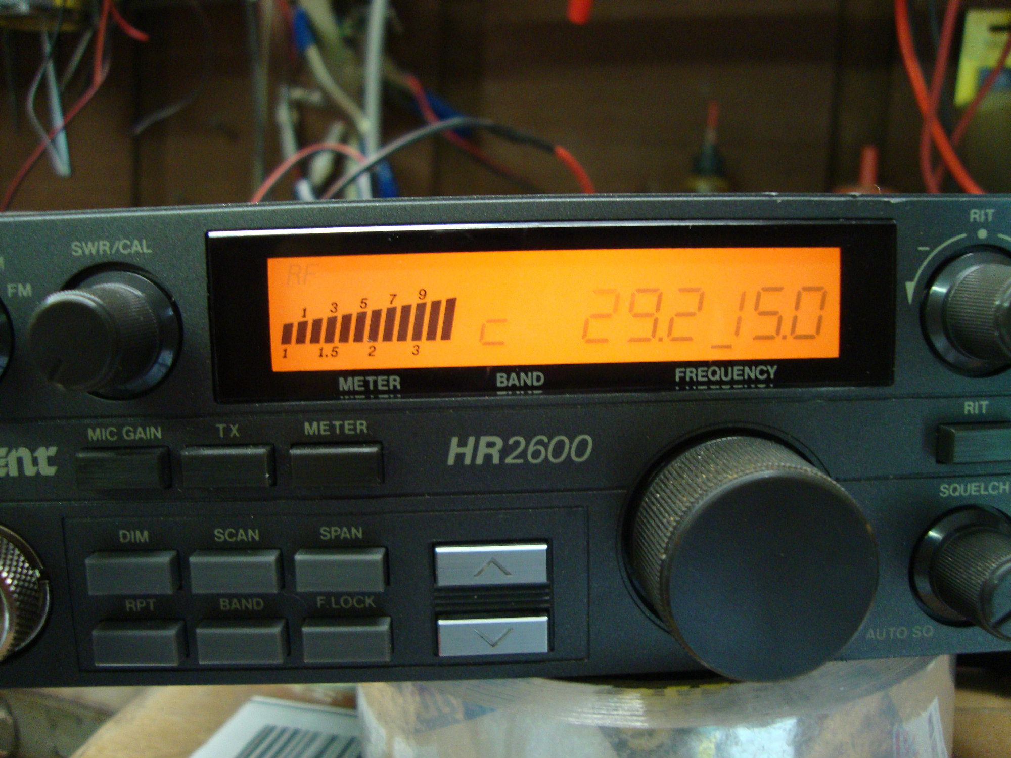

There is only problem with the radio and I have described this in the Mods Forum and am looking for a fix - if I can. The meter stays pegged out during all functions. The Meter Multi-Functions all toggle through with their display indicator …. but the meter itself stays pegged out as shown in the pic. I tried adjusting S Meter VR1, but with no effect. Hopefully this is a simple fix issue but I do not know at this point.

This first pic shown is same pic as in the thread in the Mods Forum …. showing the meter being pegged out. Is switched to Rear Toggle position so, in Band C and on 29.215, is actually on 27.215 CB channel 21

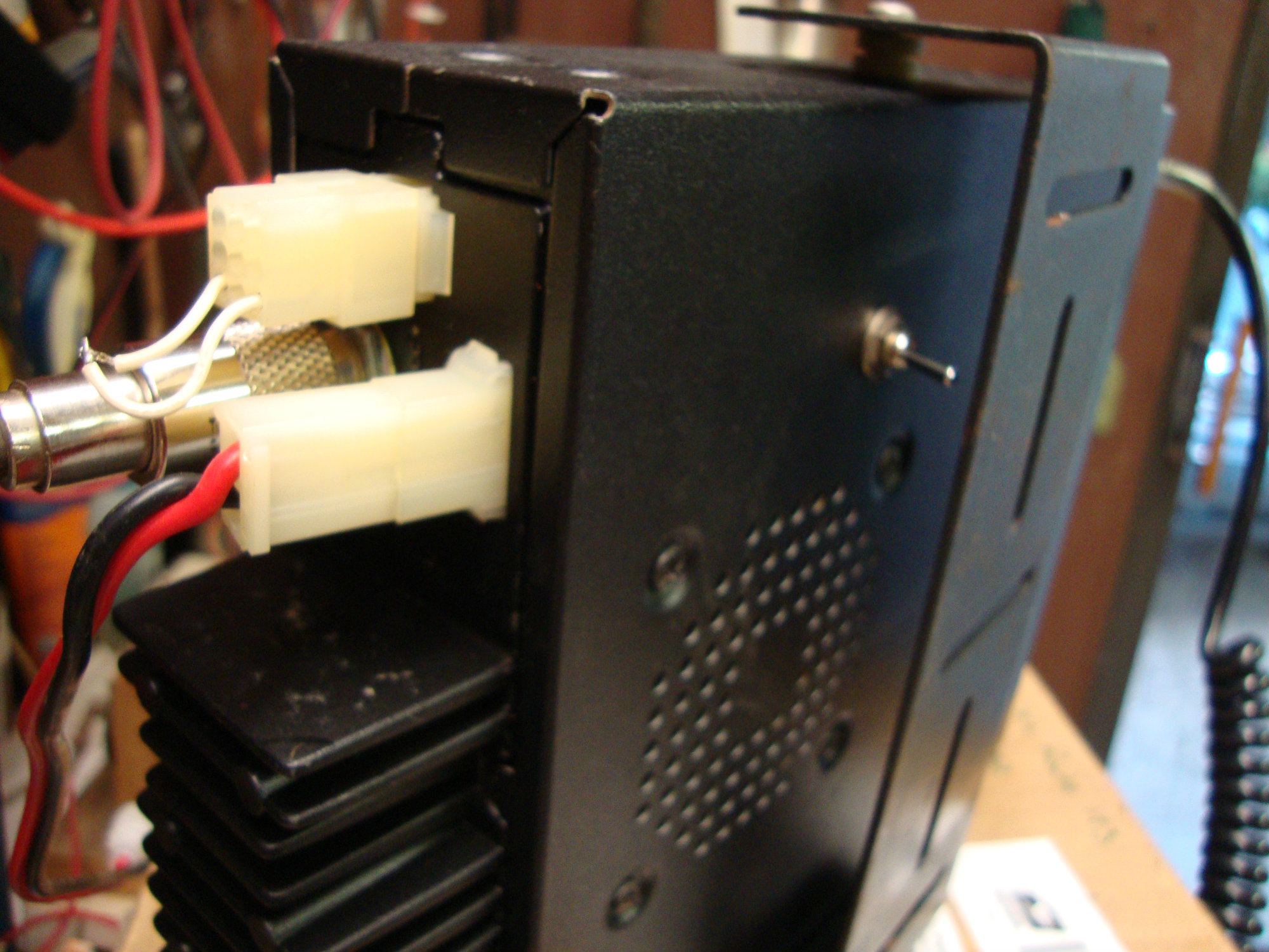

Here's the additional pics and a little more info. Both SSB are dead on the money at 12 o'clock r.i.t. and the clarifier IS open for TX. I could not remember if they came that way or not. The Left Side shows the toggle for the roger beep. Pic with radio sitting on side and viewing the bottom shows toggle for the Frequency Banks. The pic showing the front/top of bezel …. those little dings in the paint are the only marks on this radio. Rest is super clean.

I do not think it has anything to do with the meter problem, most likely there is a shorted cap that is causing the problem.
These radios are OLD ( as are all of the HR radios) and it is a common problem to find dried out/shorted/out of spec caps in them. I recommend getting a cap kit from Klondike Mike and recapping the entire radio.

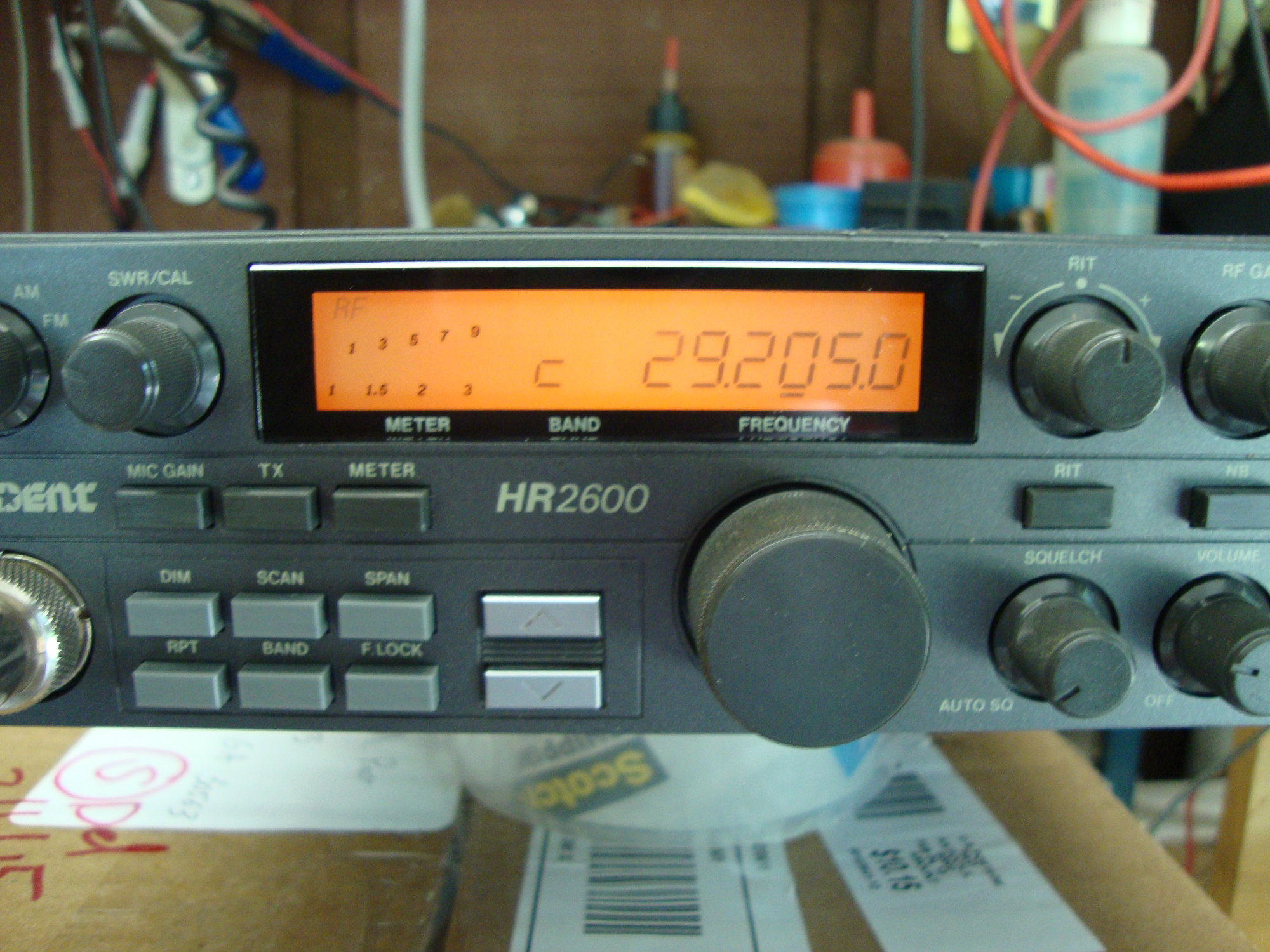

Woo Hoo !! Got this rig back out today to talk on some more and the Metering was working normally as soon as I turned it on. My older friend who owns this did not hook up or talk on this rig. He received in a package Lot that he purchased …. he knew he didn't want to use it and that I could properly check it out for him. I am suspecting that the previous owner hasn't used it in a while and it's been sitting on a shelf. I only turned it on 1 time the first day to test it …. so apparently the thing just needed to be turned on & off a few times to wake everything up good and maybe charge a capacitor or two up properly. I checked with several local contacts near & far to reset the S meter for reasonable reading. RF set to S9 reading with for the 10 watt AM/FM dead key …. and swings forward 3 more bars with modulation. MOD/SWR …. all meter functions working normally.
I also discovered that one of my mini-8 jumpers was bad and I had some SWR the other day which resulted in inflated power readings. Jumper replaced …. so now the rig is showing factory spec power of 25 watt p.e.p. on both AM & SSB. And again, the AM dead key is set at 10 watts.

Here's a fresh pic showing the meter at Zero with no incoming signal.1hr26.jpg
