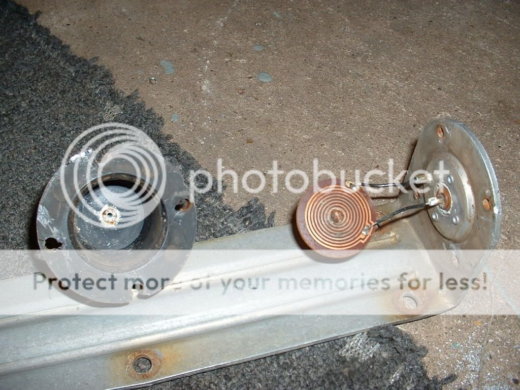

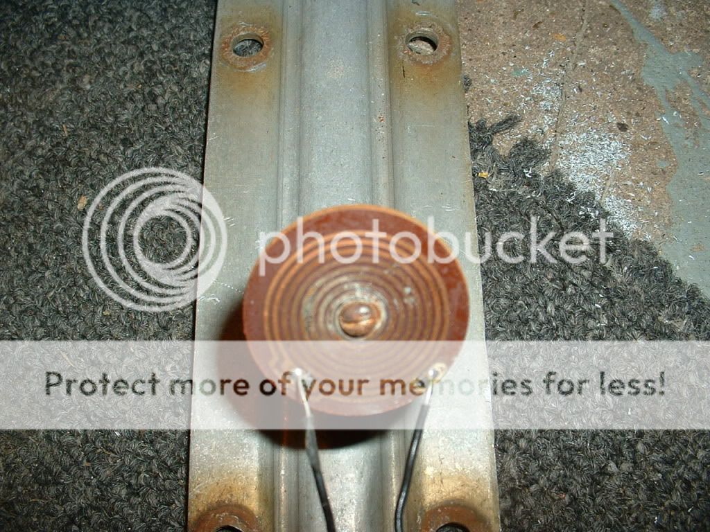

when you fried the disc Eddie, did you ever try just bridging the wire with bare wire? just a thought. it may be possiblt to get a pc board manufacturer to make a copy as i'm sure patent will be well up, even if it isn't i doubt they'd care, the other possibility is trace it and etch your own ot just guestimate that other coil and copy it, if it ain't 100% you can always compensate on radiator length, the other possibilty is to take any other 5/8 wave of similar radiator length and clone its matching system.

How did You fix it Eddie out of curiosity? just bridge burnt section of disc coil or build a new coil?

The little coil looked like it was made of foil and it had a small break. I cleaned it up a bit and put a little piece of foil across the burned area and soldered it up a little. I checked the continuity and it was good to go.

I called again and said they didn't even have drawings of the CLR. You think there Is any possible way to make the match in the picture?
Just saw this post ....I too have a CLR-2 that I rescued from my grandpa's shop after it had toppled in a wind storm . I have had it all the way apart, matching coil out, cleaned connections, put together and it works great, but i too have the itch to modify the coil for more power handling capacity.
I am wondering if you (Mr. T.) have attempted to build a new coil for yours yet and what your results were?
