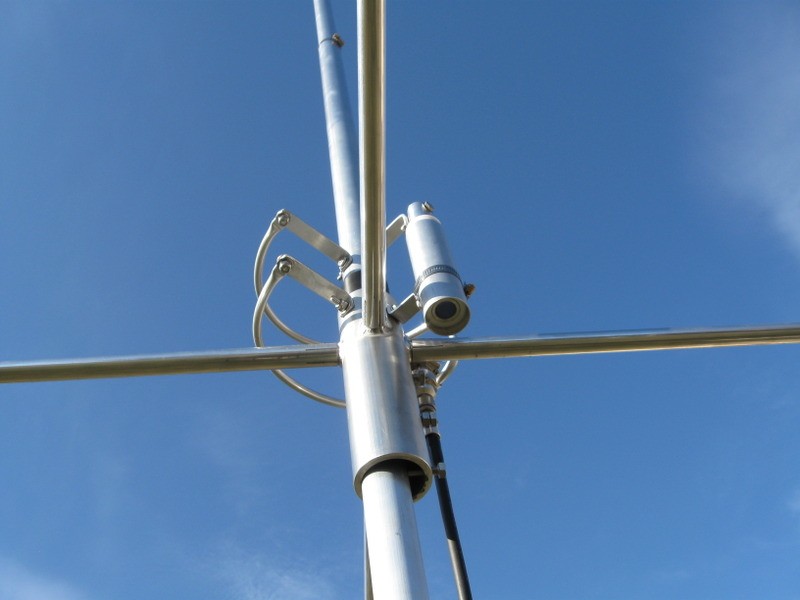

Here is an image of my Wolf .64:Wolf .64.JPG
