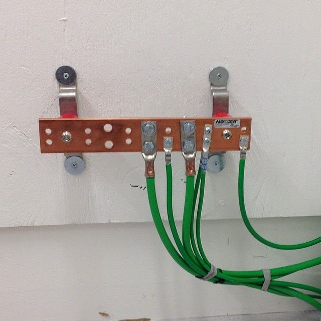

I need copper buss bar help
Groundwire: That bar will cut very easy. Hacksaw blade 18/24/32 tooth count should work well. (24 or 32 will leave a nice cut) When your done with cut a small flat or half round file will remove the "burrs" on the cut edge. The edge should be smooth to the touch, round the corners slightly also. The edge should be so that rubbing fingers or skin against it should not feel sharp/prickly.
Drilling, slow steady with sharp/clean bit. You can use a little motor oil/3 n 1 oil etc. will help a few drops should be all that's needed.(only 1/4 inch thick)
The hole size should be drilled so the "fastening" machine screw fits snuggly (1/4 inch machine screw use 5/16 bit). I use a tap and threaded my buss for station grounding, then use a hex nut plus star washer as a capture on the back. (little extra work/Just me)
You will need a "thin" film of NOALOX rubbed on the bar, plus the machine screws/washers/terminals etc. to keep any oxidation down. (again me)
The cheap screws and terminals tend to build up "gunk" (oxidation) over time and add resistance to the connection, thus making it less effective. I prefer using Brass machine screws/nuts/washers, as they are tend to be less of a dissimilar metal product and don't oxidize as quickly as the cheap Chinese type machine screws/nuts etc. availible at most big box stores.
I have a couple of these mounted also, these make it easy to add/remove grounding cables, when equipment changes "happen".
Just a couple of ideas to think about as you go along, changes "happen", it's nice to be prepared and making it easier over time.
NOTE: Remember "each" piece needs it's own grounding cable. Do NOT daisy chain equipment together, so a few extra holes added before the install, may help as "things" grow!
All the Best
Gary/W9FNB
