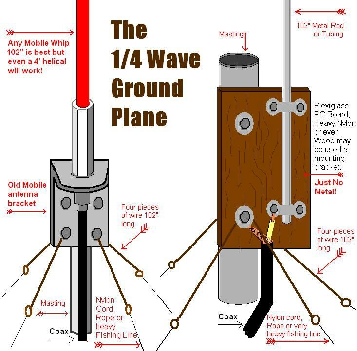

You need a good metal surface for ground plane effect. Window mount will not be very efficient and stationary only I presume. We had 15-20M ok on a mobile but much lower gets inefficient really fast.

You need a counterpoise for the Antenna to work off of, normally this metal is the body of the car.
You can add wires like Gary posted above for this, or use two antennas and make a dipole for base use.
Have a look at this thread
Homemade dipole are easy and work well.
Can be mounted vertical or horizontal.
