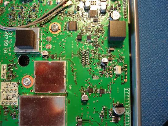

I have tested on my IC2820 the diodes guide for extended bands. Please, open the down side and look at the two rows of diodes on the right side, placed vertically (foto 1).

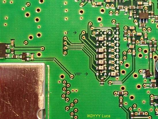

From up to down (foto 2):
First diode is not present Remove second diode: 144-150 Mhz 430-450 Mhz auto-repeater USA+ Remove fourth diode: 144-148 Mhz 430-450 Mhz+ Remove fifth diode: 144-148 Mhz 400-470 Mhz+ Remove sixth diode: 137-174 Mhz 400-470 Mhz+ Seventh diode apparently it doesn't change anything ???????????? Applying the eighth: cross-band is activated To activate cross-band procedure, press and hold two main band knobs and press ; the radio will beep and the key symbol on the left side of the display will flash; now the radio is now active in the cross-band mode.
To cancel the cross-band repeat function, please press <F>.

It didn't work for me, but I didn't get in to it too deep. It will accept the frequencies on both the TX & RX side, send them to the radio giving you a warm fuzzy feeling, but when you key up the radio's display says something like "no soup for you". No Tx
The software will work if you do the mechanical mod above.
