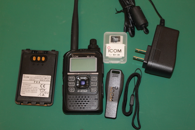

After charging the battery overnight, I was ready to try it out. Here is a picture of everything included in the box, not including the manual and CD:
The first run of these radios includes a 2GB microSD card, although the manual indicates that the microSD card is not included. The battery is an 1150 mAh slim battery and there aren't really any special accessories included.

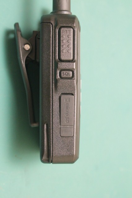

The left side of the radio incorporates a nice size PTT that is very crisp and easy to use. The SQL button is small to prevent you from accidentally hitting it. It serves two purposes: one quick press cracks the squelch open; rotating the dial while pressing SQL changes the SQL level. Note the location of the microSD card slot.

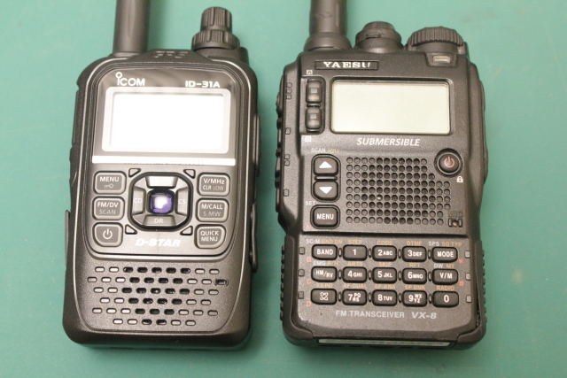

Here is a picture of the Yaesu VX-8 beside the Icom ID-31A to show a size comparison. You can see that the ID-31A is slightly smaller yet similar in size.
Here is a side shot of both the ID-31A and VX-8 to help compare the thickness of the two radios. As you can see, the ID-31A is only slightly smaller.

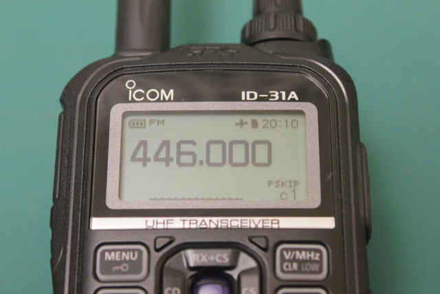

The display of the ID-31A is a very nice dot matrix screen which is very crisp and easy to read. Here is a picture showing the standard FM simplex display.

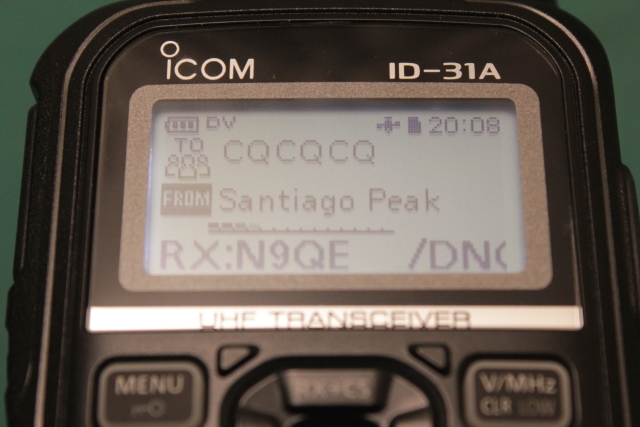

Here is a shot of the radio in D-STAR repeater mode. In this picture, you can see the time, GPS status, battery status, repeater name and destination call, as well as the callsign of the station currently talking.

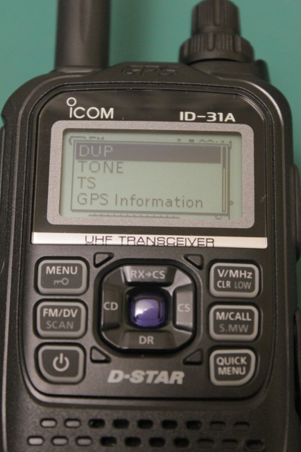

When using the regular analog radio, the QUICK MENU button toward the bottom right brings up all the functions you need to setup the radio to access a repeater:

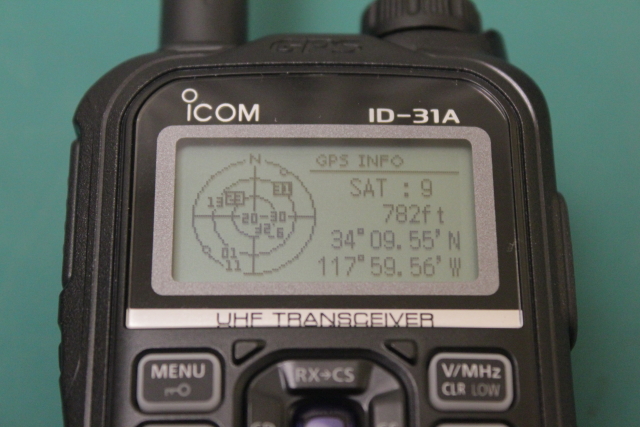

It also gives you the option to display the GPS information, assuming you have the GPS turned on. As you can see, the initial GPS screen shows you the satellites that it has locked into, as well as your current position.

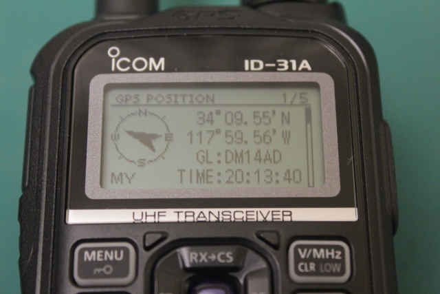

Selecting the GPS POSITION menu from the QUICK MENU displays this screen:

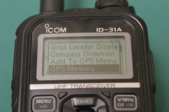

While displaying your position, if you hit the QUICK MENU button again, you get GPS display options which allow you to toggle options like ALTITUDE DISPLAY:
or GRID LOCATOR display:
You can also control the heading on the COMPASS DISPLAY, shown here:

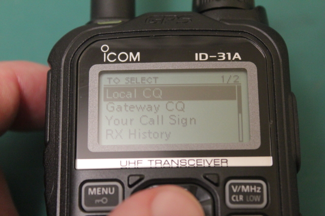

The first time you activate this screen, the TO and FROM lines on the screen may be blank. Using the direction buttons on the radio, toggle either UP or DOWN to highlight the TO line, then select it by pressing the center blue button. A new menu will pop up where you select who you want to call.
For a basic repeater CQ, just select the first menu item called LOCAL CQ. The radio will return back to the DR screen and display TO CQCQCQ.

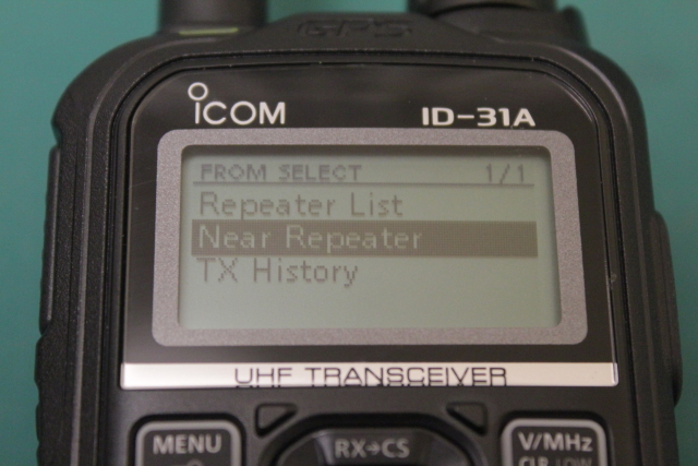

Now, use the UP/DOWN buttons to move to the FROM line and select it by pressing the blue button. This is where some of the magic happens with this new radio. You will get the resulting screen:

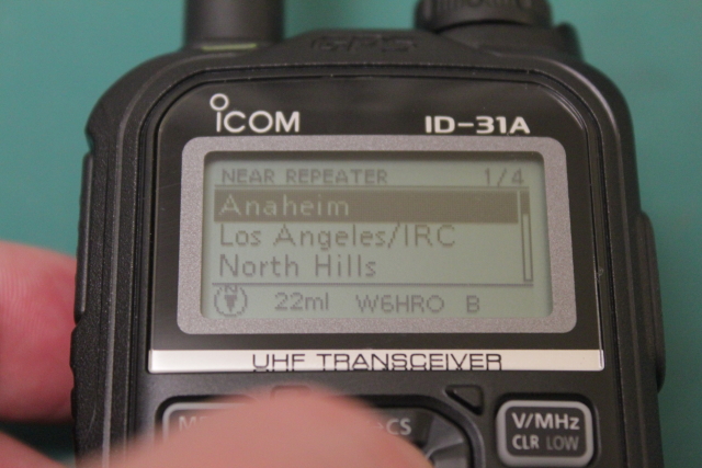

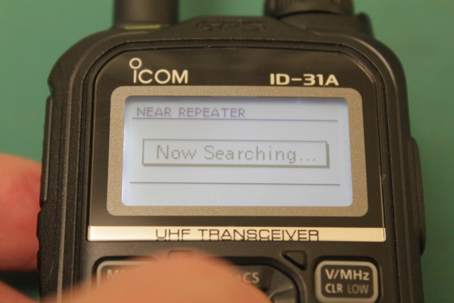

The Icom ID-31A comes pre-programmed with all of the known D-STAR repeaters! If you have the GPS enabled, select the NEAR REPEATER option and the radio will search it's memory for repeaters that are near your current location!
As you can see, the radio presented me with several repeaters in the Southern California area:
Pick the repeater you want to access and you're ready to go! The radio automatically sets RX frequency, offset, and any DCS/TONE access requirements. All you need to do is key the radio and talk! Remember, your callsign is sent as part of the data feed when you key the repeater.

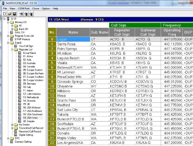

In my opinion, the best microSD card feature is the ability to configure the radio and edit memories with the included software, save the configuration on the card and then load it into the radio. This operation completely eliminates the need for cables attached to a PC! I found a local D-STAR repeater that wasn't included in the initial radio programming and was able to easily add it to the radio repeater list using the microSD card
When you load the settings file from the card, the radio's firmware asks if you which of the three load options you want: load entire configuration, load everything except "MY STATION" (callsign) info, or just load repeater lists. These options make it easy to copy repeater info to any other ID-31A.

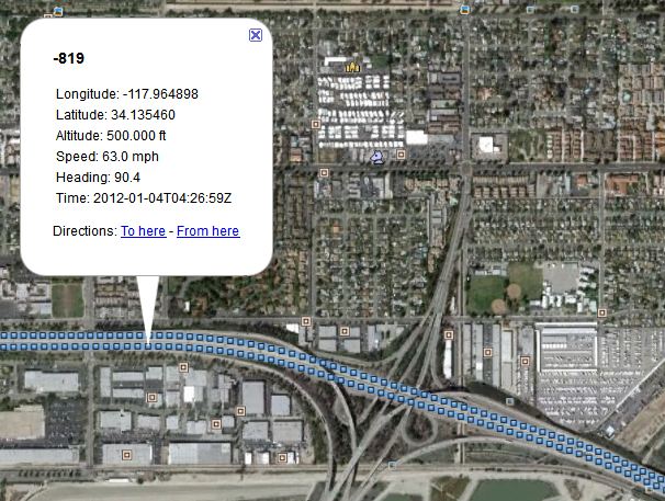

I tested the GPS logging feature, which works quite well. There are two ways to activate the logger. The first way is to just hit the QUICK MENU button and scroll down to the menu that says <<GPS LOGGER ONLY>>. It will confirm that you really want to do this and then activate. When you use this mode, all radio functions are turned off. The second method is to use the regular MENU button, go to the GPS menu and then turn GPS LOGGER to ON. This method allows you to use the radio while logging. I tossed it in my Jeep and went for a ride to test it out. To deactivate the GPS logging, you go back into the MENU and turn GPS LOGGER to OFF.
The log is saved on the microSD Card in the GPS folder. The file is in standard NMEA format. I had no problem converting the log file using GPS Babel software to Google Earth's KML format and importing it into Google Earth.
Here's a screenshot of the logger information in Google Earth:
